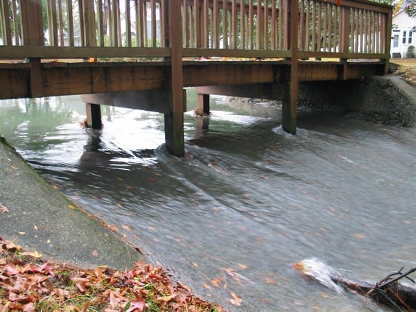

Seasons Greetings - In my new volunteer "job" as in-house engineer for our homeowner's association, we have two (2) pedestrian bridges that need replacement ASAP. My general arrangement sketches of the existing six (6) feet wide wood bridges are shown below:
In both cases replacement bridges need to be single span.
I would prefer to use prefabricated steel truss bridges such as those by Contech, or equal... but there is a problem. The pond is totally surrounded by individually owned single family homes on small lots. The only common area access is a relatively narrow tree-lined sidewalk. Doubt trucking in the bridges and equipment to set them is practical. Helicopter, maybe, but, of course cost is a big issue.
My question: Can you recommend another way to construct these limited-access bridges besides
1) Prefabricated
2) Site-built, piece-by-piece from manageable sized construction materials?

If it's built on-site using steel beams, with bolted bracing, etc. and wooden decking and rails, everything should be light enough to put on a cart and roll in. My quick back-of-the-napkin numbers say a W14x22 would probably work for a 2 girder system. If I'm way off, you might need a W16x26, which is still only about 820 lbs per girder. If you do 3 or 4 girders, they'd be somewhat lighter.

LittleInch - Clear span on the overflow bridge is needed to eliminate the two interior bents. Currently the 6x6 wood posts are not anchored to the spillway (just friction). The attached photo speaks for itself; that is less than 5" deep water tending to knock the "feet" out from under the interior bents. I'm not about to "open the can of worms" trying to anchor posts on a replacement bridge. This past spring we had to make major repairs to the spillway... that's when the BOD "woke up" and realized they needed in-house engineering input on significant projects.

SRE - yes fiberglass cost tends to be a bit higher, but there is savings in the install cost and in the long term maintenance. Definitely go with a clear span bridge replacement; those posts held by "friction" look like a collapse waiting to happen.

bugbus - I see your edit, but will comment anyway because I asked myself the same question when this project first came up. The devil is in the details... when I reverse engineered the existing bridge "design" results were shocking:
These bridges were "built" by a contractor, not designed by an engineer... and when you look, it shows.
Live load rating tops out at about 30 psf (when it was new). Should be more like 85 psf for a pedestrian bridge.
Wet, subtropical climate in Charleston. Bridges are at least 10 to 15 years old. Even though the wood is "pressure treated" (to who knows what level of preservation) much of it is visibly rotting. I have down rated live load to 20 psf based on engineering judgement.
Then, of course, the overflow bridge is laterally unstable because of the unanchored interior bents.
