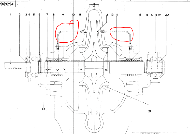

HI,

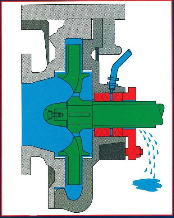

I am currently working on rectifying anissues at a pump station. In short I have three pumps connected to one suction line and one discharge line. The pumps are designed to operate individually, one duty and 2 stand by. The pumps work perfectly fine as long as there is a positive pressure going in. However once the water in the storage drops below the pump intake line, there is negative pressure in the suction. The issue is during this time, we have excessive air leaking through the off-duty pumps (packing gland). I have considered mechanical seals, but they are very expensive - especially for an old pump and I'm not sure how effective they are.
Since the pumps have VSD installed on them, I was thinking running the three pumps in parallel. So reduce the speed of the pumps. I know I will be operating the pumps inefficiently but if I can prevent air getting into the system, I can prevent the pumps from failing.
what are your thoughts?
By the way, i'm a grad engineer. Been in this job for only three months so i'm new to this stuff.
Thank you

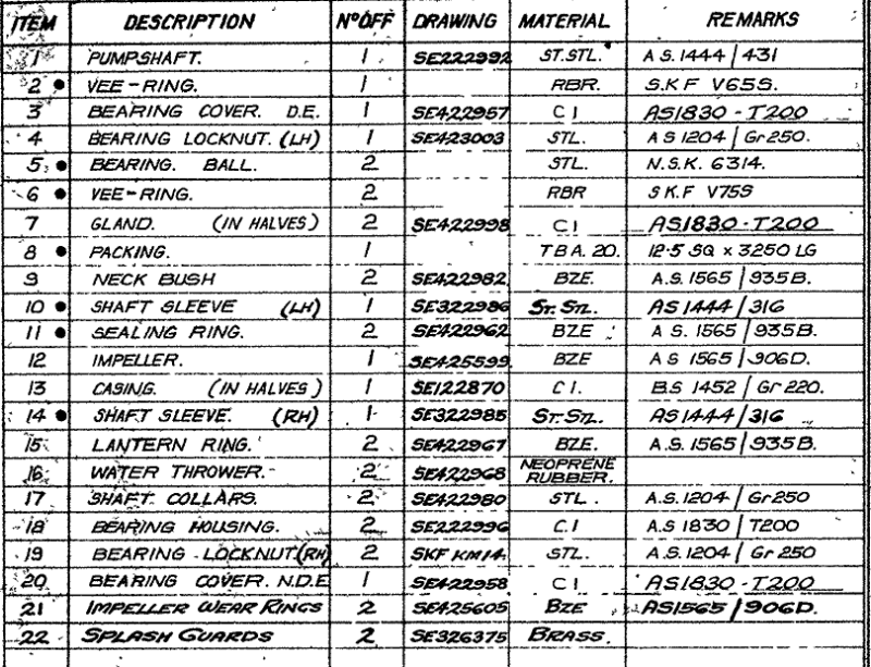

The packing is rather vague but looks like a long string? There may be alternatives which can act in both directions to prevent air entering - time to talk to a packing / seal manufacturer or pump vendor if they are still around. Or maybe you just need to replace the packing and tighten it up a bit?
