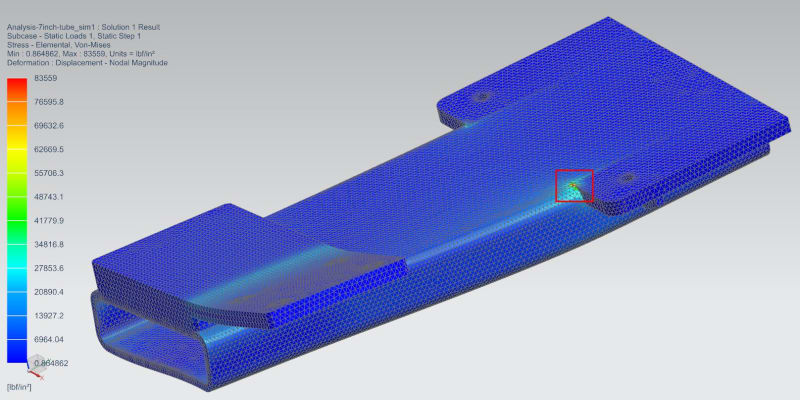

I'm no expert in FEA. But I'm trying to analyze a weldment by just uniting all the solids into one. I'm using NX design simulation. Everything looks good except for where the thin blade corner meets the tubing. Can I assume this isn't a problem? Also my Nodal stresses are much higher in that same area. Like double, but again the rest of the model looks good.

This is called stress concentration in FEA. Some are physical but some are artificial. There are several approaches to solve this issue. First check stresses in other areas, see if they look correct. Also take a very close look at the area with concentration, notice how many elements have this increased stress. And what's most important try to understand why it appeared there (examine boundary conditions, loads, contacts and so on). Refine mesh in this area, perform nonlinear analysis and see if this helps. Maybe you will have to change the geometry a bit (make this corner less sharp). You could even use shape optimization (if your solver allows it) to eliminate this concentration. However it is better to do it manually.

this is a linear run ? so in reality you'd get a small localised yielding and everything would be fine.
maybe you can do some analysis to back out the true plastic stress based on the elastic stress (Neuber ?) ?
Dont include that stress in your weld calculation. The stress is occurring at a modeling feature that wont look anything like that after the parts are welded together. The weld allowables are knocked down to account for sharp corners, slag inclusions, etc.

My assumption with small stress concentrations is that they are fine because of the ductility of the metal, unless you are looking at fatigue. They go away completely when you do a NL material solve.
Agree with rickfischer51. I would exclude [at least] the elements immediately surrounding the artificially high stress when performing the Von Mises check of the weldment. I might tack on a weld efficiency factor for this check as well depending on the material (we use 0.85). As for checking your welds, rick is right in that your end geometry won't look anything like that (I assume it's a fillet-fillet weld), and that typical weld analysis methods and knockdowns account for this. I might even take a freebody of the cross-section where the blade meets the tubing and do a hand calc (Shigley and Roarke have good examples of this).
"I'm trying to analyze a weldment by just uniting all the solids into one" … this is probably a "bad" way to model this feature, if you're going to pull this type of detail from it. The better way to model is as discrete pieces with the weld modelled (CBUSH?).

The other key skill with using NL material properties is being economical with your mesh. The mesh in the OP's question has way too many nodes, meaning that NL material would take forever to run and be really impractical. If you can keep things less than 10,000 nodes for a part like the one shown, you can iterate quickly even with NL material model. I find that I need to run models a dozen or more times before I get them right with all the boundary conditions and connections etc.
