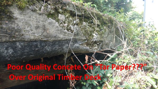

Hey all,
I've been asked by a client to look at an old timber/concrete deck (?) bridge and give it a load rating. Apparently the fire dept. was concerned their trucks would not be able to go over this bridge and serve the 9-10 houses on the dead end it leads to. Full disclosure, all my experience is in building design, but it seems like an interesting problem. After looking at the pictures it seems much older than I originally thought and I haven't been able to make it out there to take a look myself yet. Pictures are below:
Link

IMHO, the bridge is past saving; remove and replace.
The concrete deck (assume unreinforced, unless known otherwise) appears to have been placed on top of the original timber deck (now falling apart). The concrete could settle, crack, or break under load.
Just the dead load of the concrete is probably significant.
It would not be too hard to do the math that will likely support my opinion. Would need the following:
Diameter, span, and spacing of longitudinal "logs".
Three dimensions of the original timber deck.
Three dimensions of the concrete deck.
If the bridge passes the above "math" test, condition of the "logs" needs to be determined.

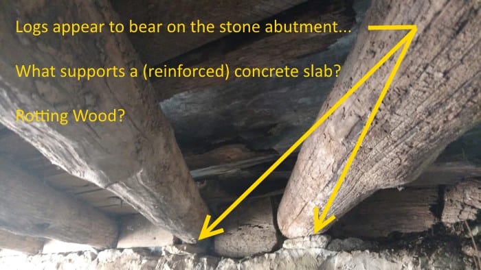

Replacement is obviously the most direct solution, if you do have to rate it (which you most likely will, since that's what they hired you to do), at the very least you'll need a copy of AASHTO's Manual for Bridge Evaluation. It includes exclusions for decks based on the spacing of the supporting members. Yours may be close enough that the capacity of the deck can be ignored.
The distribution of the wheel loads across the logs will be based on the thickness of the timber planks and the concrete, but it's out of the AASHTO Standard Specifications for Highway Bridges, Table 3.23.1. If you don't have that spec, you can post the thicknesses of those layers and I'll help you with the Wheel Fraction.
We do load ratings on bridges in that kind of shape and worse, ones that have routinely carried loads heavier than a typical fire truck for years. I wouldn't be too quick to write it off as a loss. It will require a thorough inspection, particularly for transverse cracks in the logs.
Replacing the superstructure and placing it on or behind those existing abutments should be an option.
If the concrete is as thick as it looks (or the approach grading can be raised a few inches), there may be an opportunity to use the existing planks and logs as shoring for a new reinforced concrete slab bridge. If a bond breaker, such as a couple layers of roofing felt is laid on the planks, the logs and planks could be removed after the slab cures, which would increase the flow capacity under the bridge.
Your first bridge rating (technically it's a culvert; span <20'); looks like you'll have to get your feet wet figuratively and literally. It'll probably take you longer to inspect the bridge than it will to perform the load rating. The calculations aren't difficult; one for the planks and one for the logs. Even if the owner wants to replace the bridge, I imagine they would still want the rating because that is one way to justify replacement and it will likely take some time before a construction contract can be awarded. Make sure you bring an ice pick to probe the logs and the deck planks and a piece of rebar or similar to probe the base of the abutments for scour. You might be able to get a ruler between the plank to get the plank thickness; if not drill a small hole. Take several measurements of the logs to obtain an average section.

Thanks for all the help. I'm going to advise the client that we can do an inspection and analysis but replacement may end up being a possibility. I'm wondering if the old timber was used as a form and the concrete deck is reinforced to span. Only way to know would be GPR I presume.
Looks like there was an extra pole on the RHS as you look at the bridge ( pictures 12 & 13 show the gap where the pole went).
Those curious finger like things look like concrete which escaped through the boards when it was first poured - odd looking things.
I would have thought a couple of steel channels or beans in between the poles would be sufficient - the thing only has to take one axle loading at time.

Thanks everyone - I'm wondering if there is a chance the wood framing was shoring to begin with and the concrete is reinforced? If that's a possibility it seems we would need to scan it to verify rebar. Seem reasonable?
