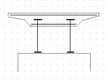

Here's another thought... Forego all the secondary steel framing and go with precast deck panels. I'm calculating out that you will have a 4.6ft cantilever either side. A 6" thick concrete deck should be sufficient. Fasten longitudinally oriented recycled plastic lumber nailers to the top of the deck and then nail your IPE into that. This will also make your railing post connection detail quite a bit more straightforward. Your biggest concerns with this would be...
1. Weight. Ensure new Strength 1 load does not exceed old load on foundations.
2. Whether or not you want to pour a closure pour at each of the transverse joints.
3. Do you envision them lifting panels into place with a crane or rolling them out on dollies and picking them with an excavator/forklift.
4. How to make the connection between the panel and the top flange of the girder. This may be the most expensive field portion of the work. This is typically still going to need a CIP haunch.
5. Will you want to have some drain hole blockouts every so often to mitigate ponding water?
I offer this perspective from an area of the country where we do more concrete work than steel work so it might not make sense in your part of the country. With the option you described, if you want to flush frame the transverse W sections perpendicular to the girders I foresee a lot of expensive in-field steel connection work.

Good point SRE. Is 14' a need or a wish? A clear width of 10' can likely be done at a cost that's half or less that of the 14' width, at least for the wood deck option. The difference might not be as dramatic for the precast panels, but the 14' option with a 5'+ cantilever, will require a positive connection between the panel and the girder (the panels will need to be anchored down to the girders to prevent tipping with the H-10 truck over to one side).

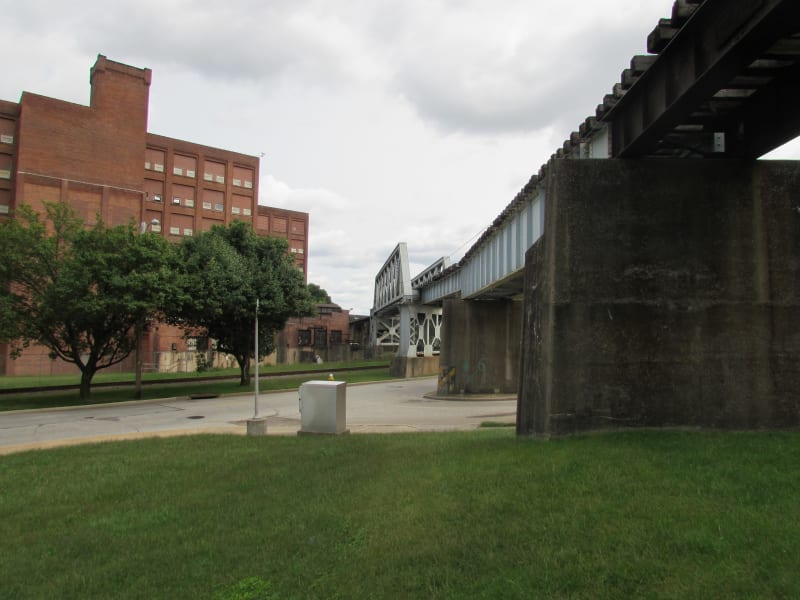

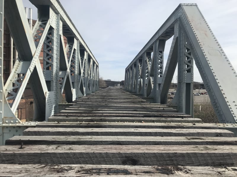

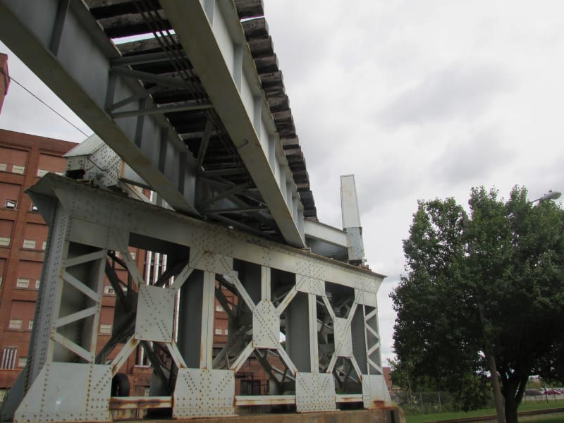

Here's a couple photos.
3Fan said:
The bridge was used until the mid 90's and is in really good condition.
...all the plate girders are not the same depth in adjoining spans.
That won't be a problem, H10 loading on a RR bridge in good condition is just "noise". By 1900, RR bridges were commonly designed for Cooper E40 (40K per locomotive driving axle, followed by rail cars at 4K / ft of track... and that is for steam locomotives which pound the rails).
If the bridge had been upgraded, at least Cooper E72 (Cooper E40 x 1.8) by the 1990's.
Nice photos, what (approximate) location?
Edit: If the client want's to save a lot of money, see if you can convince them to just put decking on the cross ties (each cross tie likely about 8.5' to 9' long). We convinced the organization that I worked with to do this on the 4 or 5 timber RR trestles that lead up to the wider 1900 steel swing span.
[idea]
Totally agree that the H10 won't be noticed by the existing structure. We are not to analyze the existing structure.
Not sure the condition of the cross ties and the owner stated he wanted them removed. Good thought though, if owner wanted a 9' wide deck. Another local rails to trails project just laid ties right beside each other and paved over them. Those girders were spaced wider than these and only resulted in 2' overhangs.
Project is in Northeast Ohio.

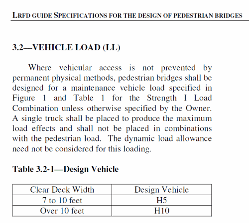

Understood, I promise not to be a "pest", (and you may know this) but here is one more possible "sales" tactic to put in your pocket if the Owner balks at the price of 14' wide, H10 structure:
An AASHTO 7' to 10' wide, H5 structure "AASHTO LRFD Guide Specifications for the Design of Pedestrian Bridges"
I don't have the standard but do have the (public) original vesion final draft, see attachment.

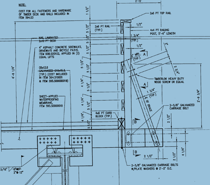

Just an update on this project. I was able to visit the site and get up on top of the bridge. The truss inside to inside width will be our controlling width of about 12'. The girder spacings vary from 6.0' to 6.5' to 8'. So the overhangs will vary. One snag we noticed at the site was that the girders are all built up sections with plate and angles and constructed with rivet. The rivets are stitched at about 4" centers in the flanges. The heads protrude up maybe 3/4" making placing anything flat on the existing flange very difficult to do. We have tried to convince the owner to use CIP concrete but he's not liking that idea. He's still stuck on using wood only or a steel and wood combination. Not sure how we would attempt to mount steel to the top of the flanges with the rivet heads sticking up. The existing wood ties that were still in place were notched to go over the heads.
Here's a detail we used. A C-channel was welded on the girder to provide a smooth surface for the nail-laminated wood deck. C-shaped plates around the girder flanges provide uplift restraint. They are nailed in between the deck boards. The wearing surface is two lifts of HMA on a waterproof membrane.
Albany County Rail-Trail - Normans Kill Bridge
