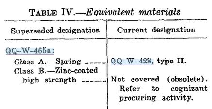

I am looking to see if anybody on here has any info on an old spec for wire or a modern equivalent . The Spec. AN-00-W-429 seems to have been discontinued and purged from most record books that I can access. This wire is very similar to piano wire, but apparently is not heat treated after manufacture. The usage in this instance is the diagonal bracing between the spar posts on a two spar wing inside the wing. I found several references to the spec on older wooden aircraft from Beech, Piper, and a bowers fly baby, but nowhere does anybody say what it is, or if there is a modern equivalent. If anybody has a copy of this spec in an old archive and is willing to share, I would much appreciate it. The aircraft in this case is pre WW2.
B.E.
potential clue (from QQ-W-412):
Checking 465a, the properties listed for Class B align perfectly with the properties listed for QQ-W-429 in my previous post above (209-308ksi). This leads me to believe 429 was intended to superseded 465a Class B, but was shortly obsoleted. The cancellation notice for 465a says that it was superseded by 428, but doesn't mention the omission of the zinc coated Class B

In this case it is," Antique Technical conformity-to-spec..". The usage in this instance is the diagonal bracing wire between the spar posts on a two spar wing inside the wing .As you say there are several tie rods and diagonals commercially available that could be used, but in this case the Glider is being restored to museum quality flying status. I and several friends have been searching for several months and keep going round in circles on this one. Coming to Eng Tips was pretty much a last result with pretty much the same results .The AN-00-W-429 spec appeared for several years, then showed up as superceded by AN-L-25 which in turn shows up as superceded . But with no clue as by what. At some point we are going to have to give up on this and select an un annealed cold drawn wire of the same tensile strength ( Possibly 428.), to make the wire bracing.
