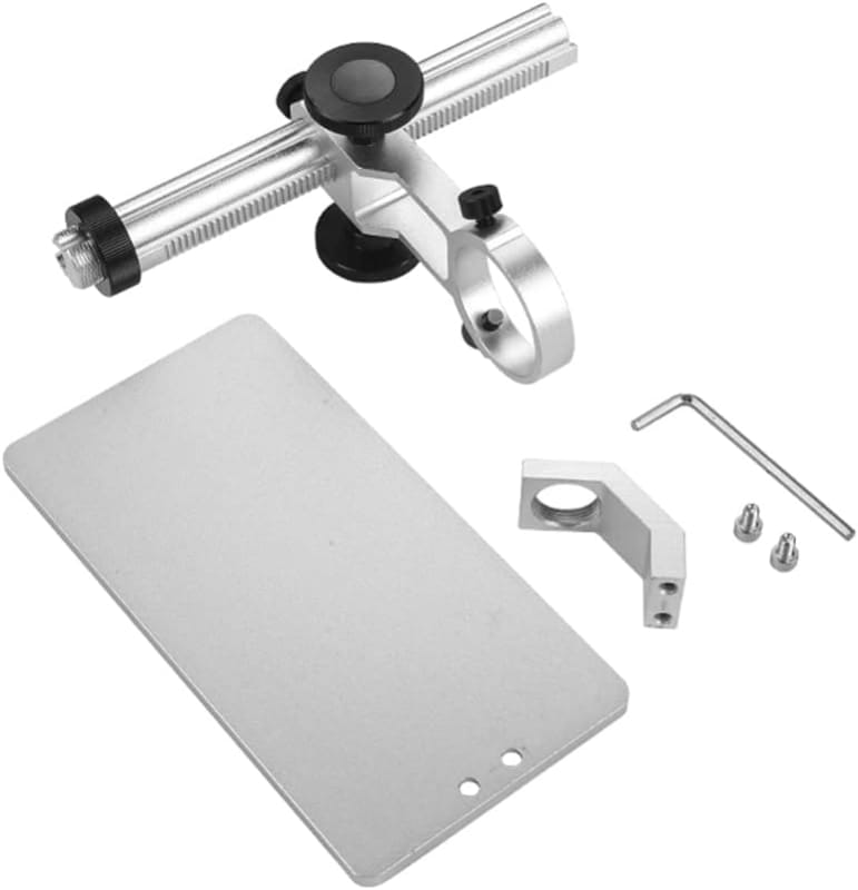

I am looking for off the shelf parts for a rack and pinion for something like a microscope, similar to the attachment. Does anyone know who might sell a pinion assembly (knobs and all) to go with a rack? I am trying to mount a stereo camera and need the adjustment capability. Thank you

Thanks, I have seen the microscope folks but that is way too expensive. The assembly I attached a picture of was about $25. I am looking for components to help me do that same thing.

I'm looking in that picture and I see a custom extrusion for the support and another custom extrusion to hold the crank/knob assembly. Do you want just the tiny sliver of rack?

Right click the image that 3DDave kindly posted for you and select "search image with Google". You'll find that there are many microscope stages that seem to use that same aluminum profile with the rack machined. So, it's likely a stock extrusion somewhere. You just need to find the somewhere.
