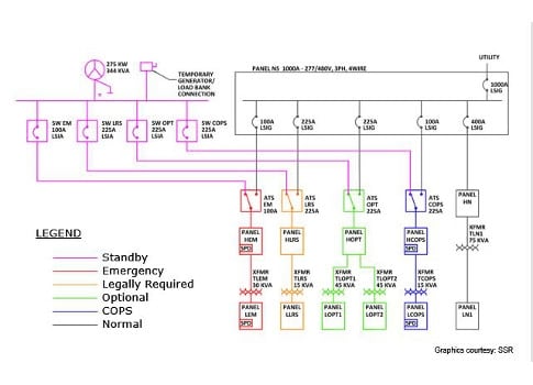

@David: If you have just life safety (egress lighting) than one ATS is enough. However COPs requires its own ATS. Ditto for legally required. Fire pumps adds a forth. Optional might even push you to five ATSs.
Here is what is typical today:
Some design standards (like those for VA hospitals) don't like large ATSs (ie over 800amps) so high capacity emergency branches often result in additional ATSs over the code minimum.

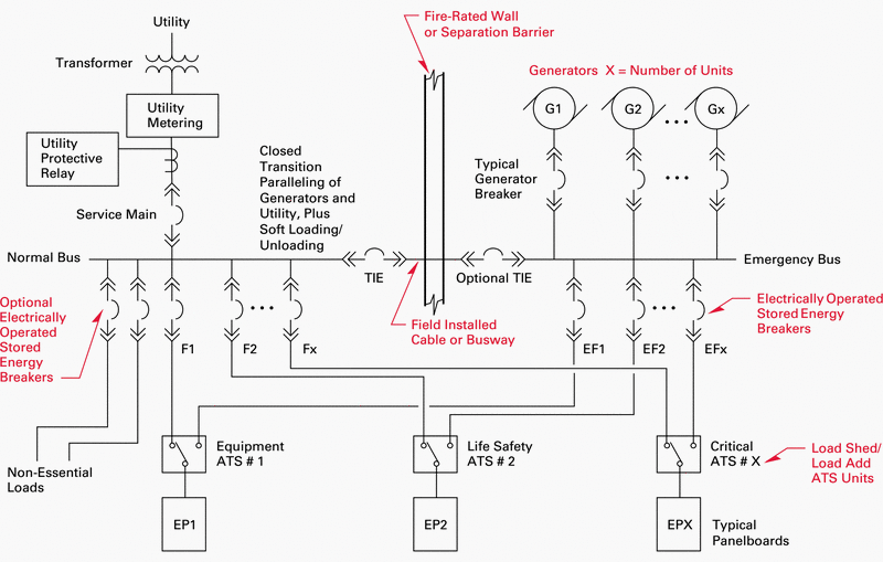

FWIW, if I was to go the parallel route, my system would look something like this- minus the utility of course:
single-line-diagram-healthcare-facility-generator-backup-utility-interconnect_oogv20.gif
What drives the need for either Critical or Equipment? Not every installation that needs an emergency generator needs more than Life Safety.
COPs comes from the fact this building could be used for continuity of government during times of need- hence meeting the requirements of article 708. When the building is not needed for emergency operations or command, its still nice to have a dedicated, protected branch for the computers and sensitive lab equipment. Legally required comes again from article 700 of the NEC- loads that while essential can not share the life safety ATS.
Regarding an equipment ATS Elevators and essential motors need delayed transition in order to demagnetize. Not doing so can cause inrush high enough to trip OCPDs and even damage elevator equipment. The elevator cab lights are on the life safety circuit, no one notices when the elevator stops for a few seconds and then restarts.

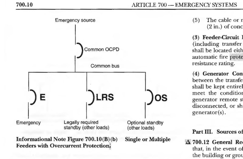

Are you confusing “shall be permitted to” with “shall”? You still haven’t defined a use that goes beyond egress lighting. Any facility with a legitimate “continuity of government” function certainly wouldn’t go for a 1001 ATS fantasy system.

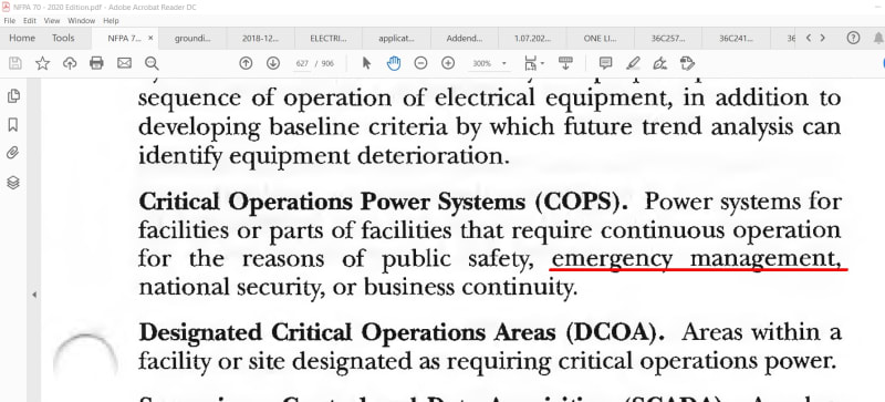

David, do you have a code 2014, 2017 or 2020 book on hand? I think excerpts from the code may help in conveying my point of view-
If this building ever takes the roll of emergency management during a disaster, the power system aiding in the efforts (computers, radio devices, hard wired phones, liaison devices, meeting room lighting, projection screens, ect) is considered essential and thus those having jurisdiction of (or over) this building have the discretion to require (or at least ask for) a COPs system.
The cops system itself must be seperate from all other electrical, including life safety, so that alone will require at least one ATS or an independent piece of gear with two sources of power.
A COPs system isn't unique, some local police and fire departments might have them, 911 centers, municipal buildings, financial institutions, ect all the way up to military sites and nuclear research faculties.
Think of it exactly as the critical branch in a hospital, but instead of medical equipment you've got a computer plugged in tracking a hurricane or taking emergency dispatch reports. Nothing more special than that.

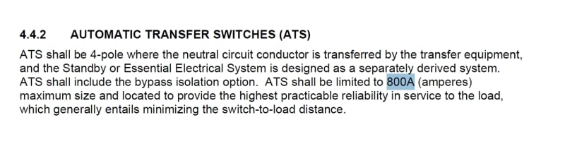

Earlier I made a claim that some standards either require, force, increase, or limit the size of ATSs in addition to what is already required by the NEC.

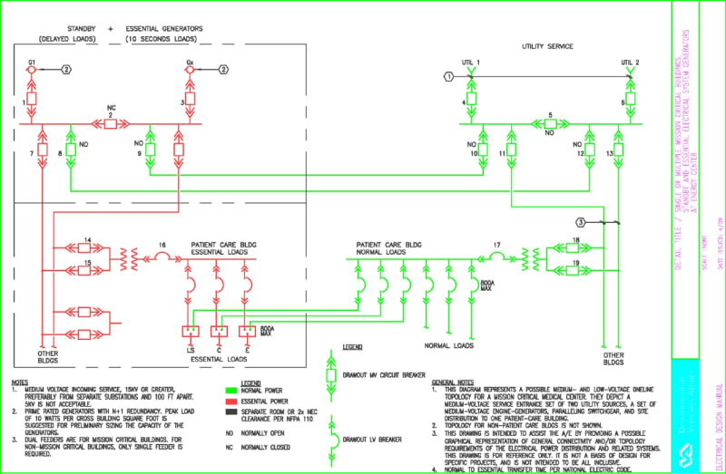

Here is an example from Department of Veterans Affairs Design Guide for Hospitals, Laboratories and Animal Research Facilities:
Paralleling of gens is permitted, however an emergency system totally separate from the normal system is still required with a minimum of two EM feeders. ATSs are shown despite motorized breakers, and both the normal and emergency branches are limited to 800 amps maximum.
Thus a large facility may have upwards of 56 or more ATSs.
Just to be fair I'm not trying to "rub" anyone or prove them wrong, rather referencing like standards which are influencing or dictating my designs.
VA design doc:
800 amp ATS limit:
"Ultimate" Generic Design:
It may seem silly, but smaller subdivided equipment is more reliable day to day. In an emergency it is easier to deal with small 225 amp ATS than a 4000 amp behemoth.
