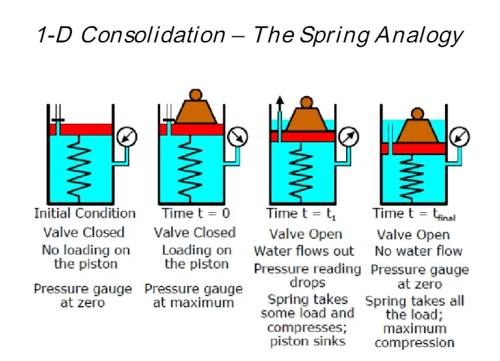

My first guess would be that the indicator is set up such that displacement at time(x)= dial reading at time(0) minus dial reading at time(x). However, I believe I would check with the lab to confirm this.
Generally, Oedometer tests are performed by applying various loads to a soil sample and grading the deformation response. The results from these tests are used to predict how the soil in the field will deform in response to an advance in effective stress.
I think Haris comment makes sense. T diagram below could be the case. Note the changes in volume are measured in each stage at varies time interval, and the change decreases in succession compressions.
