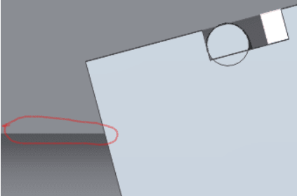

So I have this odd size port for a transducer that is 0.5906in diameter. I need a way to keep the transducer in this port since it will be measuring considerable pressures: rated to 10k psi. I can get a retaining ring - but I was thinking I could also do something a little more robust like a threaded retaining ring or a bolt with a thru port for the wires to reach the PCB, but I'm struggling finding the right size... do I just need to have a custom bolt created? Any recommendations are very welcome. Thank you in advance for reading.

So what I'm seeing is a stepped machined port at an angle to the outer edge with some sort of instrument with a single O ring seal?
I assume that disc shaped circlip type thing is what you have at the moment holding in the instrument at 10,000 psi?

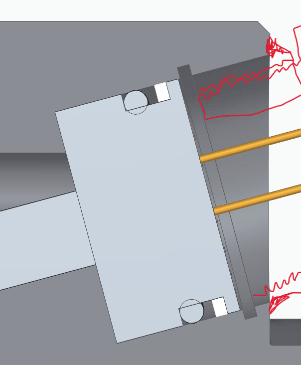

That bottom edge is the weak point as I'm sure you know, but it doesn't give you any metal to add anything really without adding / welding on an angled boss in which to screw in a holding bolt. Like I've drawn in red.
LittleInch, yup! The critical areas you described are my concern and that is a retaining ring groove that the screw you drew is touching. If I were to do a threaded component to hold the transducer I would negate the retaining ring groove. I hadn't thought of spot welding as an option so thank you for that idea! I'm unsure we could do that with the sensitivity of the wires but that is something I'll look into. Maybe a retaining ring is the best option for holding this in at 10,000 psi, what do you think? Also, thank you so much for your response!

That bottom corner though is going to be your issue.
Can you not drill it a bit deeper?

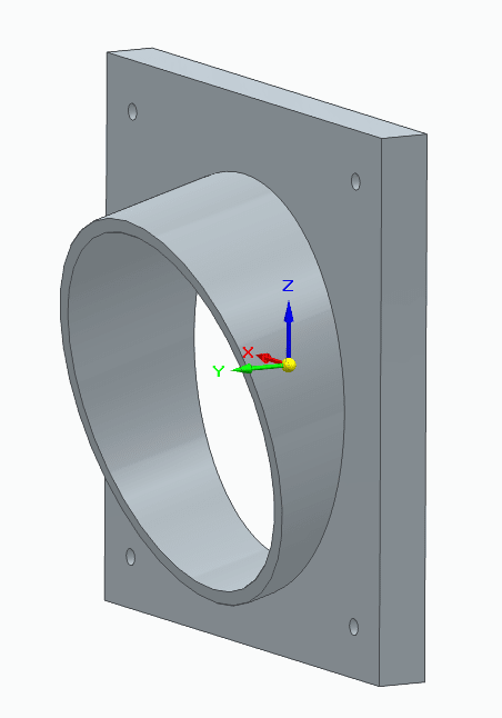

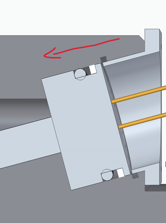

I think the fillet welding an angled screw inset might be an issue for two reasons - heat affected area damaging the transducer and in the screenshot below with the red arrow shows the direction of installation of the transducer, so there's no option to weld the angled screw insert without the transducer present. It also includes a rough sketch of something I thought of just now - second screenshot has better view of that by itself though.
I hadn't determined a way I'd like to secure it in place yet - I've been fiddling with the location and had to figure that first since it will be measuring pressure with direct contact to the fluid. I really was thinking a retaining ring.

Some gash back-of-envelope calculations suggest that 10,000 psi acting across a 15mm diameter would exert about three times the load you'd normally expect a 15 x 1 mm DIN 472 internal circlip to retain (and scaling off the diagram, I think the groove is too narrow to accommodate even that thickness of clip).
Is there any scope for cutting the 15mm section of the port substantially deeper, leaving more room at the outboard end for effective fastenings?
What's the paler grey section at the top of the sketch?

EdStainless, is the drawing I just did somewhat picturing a segmented plug with a lower flange (lip)? I could replace the extruded metal plug portion with a rubber insert and create a flat plate with a through hole to allow room for the wires - allowing some give to the transducer and reducing the chance for failure.
LittleInch, I can't drill too much deeper since the wall thickness between the transducer and bore where the fluid will flow through is about 0.125" and with 10,000psi I need all the wall thickness I can get [laughtears]
Zeusfaber, the paler grey section at the top is the second screenshot but in the assembly in a section view. I'll have to adjust the dimensions as the vertical height is too large for this application, but I thought it worked for conveying a rough idea. Love the description of back-of-envelope calculations.
Your second screenshot is a much better idea IMHO. Think your bolt holes look a bit puny and you might need more.
If you can make the square end round with constant depth then you can easily add more holes - you might even be able to use a standard slip on flange, but whatever - its a much better thing than the inner ring.
