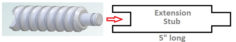

I'm an electrical engineer that tinkers with mechanics as a hobby. I'm adding CNC capability to my 10x22 lathe.
I have a ballscrew for the Z axis. It's long enough to allow full carriage travel, however if I could extend the not threaded floating end by 5" it would make mounting the floating end much easier. The captive end is mounted in a bearing block with a lock-nut that prevents movement along the length of the ballscrew. So the floating end just floats.
The shaft size at the floating end (reduced diameter stub) is 15mm in diameter to match the bearing in the floating end bearing block.
Plan is to make a 5" stub starting with a 20mm steel round I happen to have on hand and boring a 15mm hole (interference fit) to mate with the 15mm stub on the end of the ballscrew, and then machine the other end of the round to 15mm to match the bearing in the bearing block.
Plan is to put the ballscrew in the freezer, and the new 5" stub in the oven and then quickly tap the two together to hopefully lock the new stub to the end of the ballscrew.
Question #1 how much under size should that 15mm hole be to; be tight enough to lock the new stub to the ballscrew but not be so tight that the frozen ballscrew and heated stub won't go together with a few taps of a brass hammer?
Question # 2 in a perfect world the new stub will be perfectly aligned with the ballscrew, but this is not a perfect world so I'm thinking I should probably machine the 15mm end of the new stub after it's mated to the ballscrew even though it would be easier to do it before hand. Thoughts?

The amount of interference needed I think will be defined by what type of loading it's going to see. What are the operational loads? For this type of joint, you can calculate the radial interference pressure seen at the contacting surfaces. This and friction are the only things that will be holding the joint together. There's two types of loading you'll have to consider, your operational axial loads (tension / compression) and the loading seen during machining (torque due to cutter contact). This type of interference fit joint will result in the extension stub cylinder region seeing a constant build stress. The cylinder region can be assumed fixed at the base (bottom of hole) and will be forced open radially by the interference fit, thereby putting the inner surface of the cylinder at the base of the hole into tension.

I think your 20mm bar does not have enough wall thickness to get a good interference fit, but the worst that would happen is that you will create a new problem to solve and learn from. Have a look at this ISO 286 fit info summarized in a Flender catalog to get an shrink fit with no key - as indicated you would need to calculate the hub stress.
Edit - that sucks, the shrink fit classes H6 and u6, v6, x6 are not listed in that literature. It woud require finding that data.

I second using ISO 286 as a reference for fits. It's freely available on most bearing manufacturers' websites.
For assembling interference fit items, I'll set a bore gauge to 0.005" over the shaft diameter. Heat until the bore gauge passes freely and then assemble. A temperature differential of around 180 degrees F is also sufficient for assembly of press fits. The gearbox techs all spit on their couplings. If the drop bounces around on the surface you're ready for assembly.
Also consider a clearance fit and retaining compound if your wall thickness doesn't support an interference fit.

Far easier to find a longer screw and reduce the length and make the end feature.

yeah, a 20mm dia shaft with a 15mm dia hole is only 2.5mm wall ...
if you go this way, be vewy, vewy careful ... I'd machine the shaft, and measure carefully, and then cut the hole to suit. a 15.00mm shaft may want a 13.00mm hole. IDK the ISO spec, maybe it tells you this ?
but what about a cross-bolt (instead of thermal interference) ?

So I made the stub, bored it to ~0.0005" under, I think it was probably closer to 0.0007" hard to tell because I was using telescoping gauge to measure bore and even after heating the stub and freezing the ballscrew it took a few raps with a brass hammer to get it all the way in. I put a few drops of Loctite 609 on the joint, so between the Loctite and the interference fit it think it's pretty solid. There is no power or force displaced across this joint, this end is simply rotating in a "floating bearing" at the far end of the lathe where the tailstock is.
Final step is to trim the stub length and turn the end to match the bearing, but that's easy.
