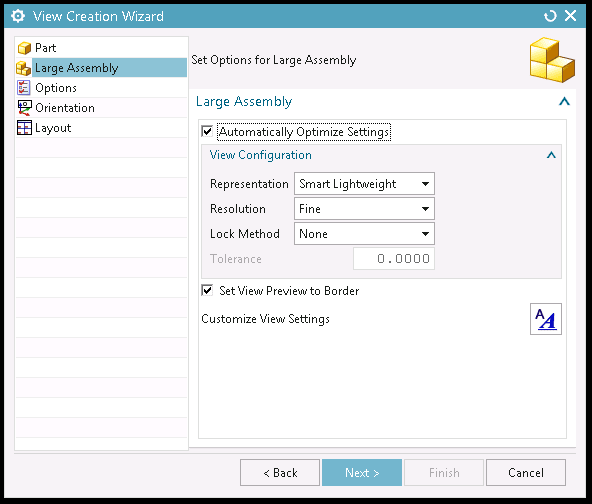

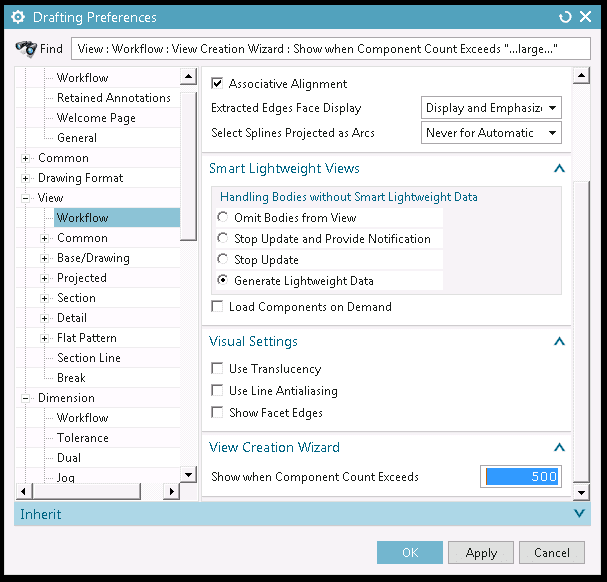

Why don't you use the View Creation wizzard? When you make the below setting in the Drafting Preferences,
the Wizzard will give you more options for large assemblies (Without that setting you don't see these)
Also, have a look at representations. This will create lightweight representations on the toplevel of your assembly. You can load your assembly structure only and still see your complete 3D model.
There are some restrictions when you you these on your drawings (no section cuts, no high detail) but for creating your views it is really fast.
[URL unfurl="true"]https://docs.plm.automation.siemens.com/tdoc/nx/12.0.2/nx_help/#uid:large_assem_assy_repres[/url]
After you have placed the view(s), you can then load the component(s) to get the full data and you will have the full capabilities again.
