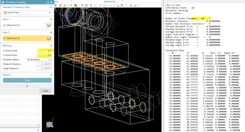

Here is an image to give you an idea. Notice we have 10 in both places for points to check and the result was it checked 64 points. If I do two different surfaces I get a totally different number of points checked. Sometimes the checker will have 100 listed in both places and have only 8 points checked in the result.
They dont like us posting any actual files, but I could make a simple file with two blocks for an example if you think it would help. Personally I think we just dont fully understand how it works.

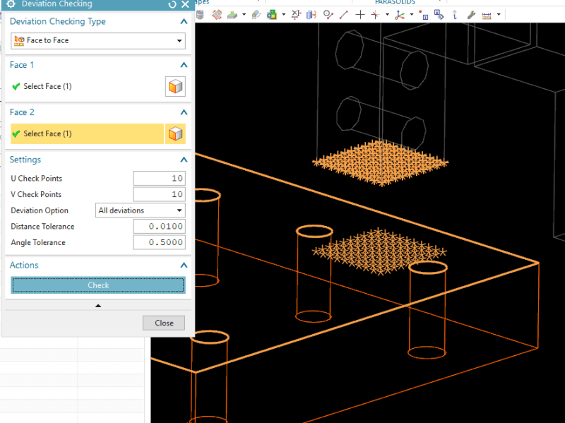

Ok, I see what you are describing now. I guess I never noticed it before. It looks like the UV points are generated based on the first surface picked and check points are thrown out if there is no overlap with the 2nd surface. In the pic below (using the default 10 U and 10 V points), you end up with 80 check points if you pick the small block's face first. If you pick the large block first, you end up with 20 check points.
I'd suggest picking the smaller surface first and increasing the number of check points if you feel that you need more accuracy.

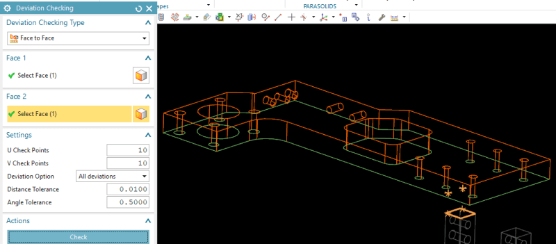

If you have it set to 10 U Check Points and 10 V Check Points, it will create a pattern of points on the first surface you select that is 10 x 10 points across. A total of 100 points. This pattern of 100 points will always be the overall size of the surface. If the surface is a perfect square, all 100 points will fall on the surface. If the surface is "L" shaped for instance, then some of the spots will miss the surface and only the spots that touch the surface will be counted. So different shaped surfaces will have different quantities of spots that will land on them.
Then it will project those points to the second surface you select. Any points that miss the second surface will not be counted. So by selecting the smaller surface first you will allow more points to connect between the two surface to be checked.
Example 1 : First surface is small square shaped. You can see the full 100 spots are projected to the larger (second) surface.

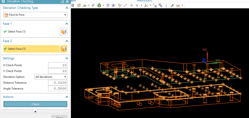

Example 2 : The larger surface was selected first and the points are so spread out over that surface, only two are projected to the smaller (second) surface.
Example 3 : You can see here how the points all cover the upper surface (first surface) and project to the second surface. They do not cover the entire second surface and extend off the edge of it as well. This gave it a total of 73 check points.
Actually I think I may be wrong on the second surface. Points that miss that surface do seem to still be counted now that I look at it again.
