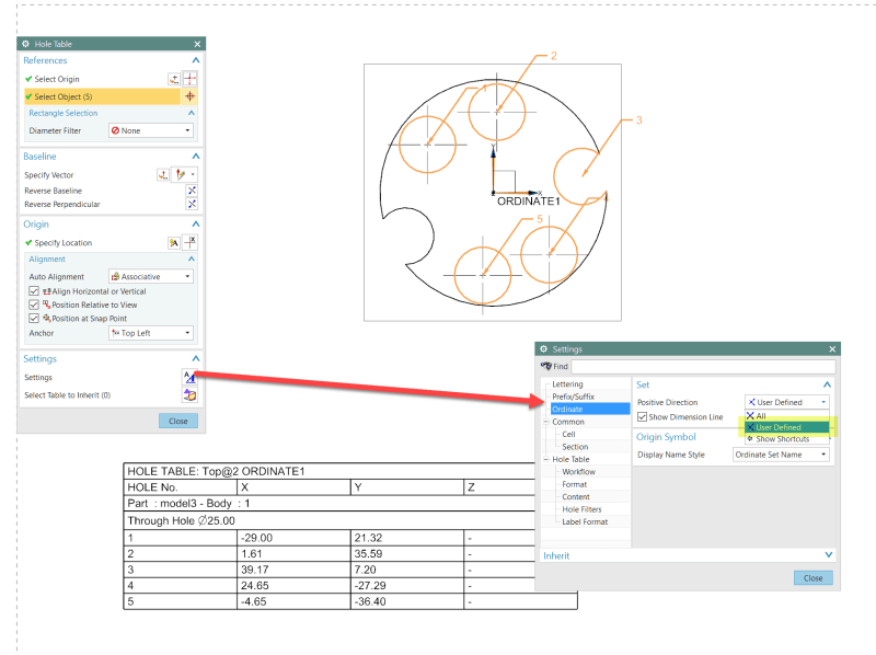

Is it possible to have an NX hole table show Negative values on the drawing. Ordinate is in center of part so i have some holes above and some below. Thanks
change the positive direction in the settings for the hole table to 'user defined' (see image below).
