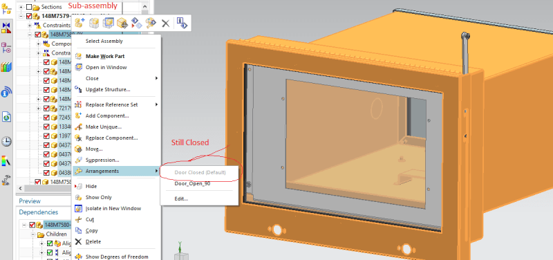

I have an assembly. Three levels. Lowest level is a piano hinge (two components, each hinge half). I have an arrangement in this assembly "hinge open" and "hinge closed". Next assembly level up is an enclosure sub assembly. A box with a lid, joined by the hinge. At this level, I can change the assembly arrangement of the hinge and the lid follows as it should. Now, the top level assembly has items attached to the lid, a glass window and sealing gaskets etc. At this level, when I change the assembly arrangement of the hinge, two levels down, the glass and gaskets etc. remain in place and their constraints break. These components should remain attached to the door and move with it. Any ideas why this wouldn't be happening?

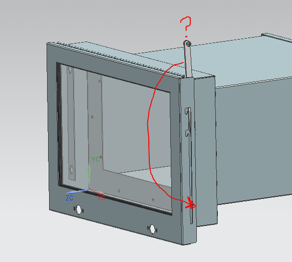

So you are saying that my top level arrangement drives lower level arrangement? I don't see in the documentation how that works. Anyways, after studying it further, I had some improper constraints, so I got it working now from the bottom up, at least for now. Now the issue I have is with this door support between the enclosure and lid that keeps the door open. It is a pin in slot type of device. If I switch arrangements so the door is open, and then switch back, the solution it finds maintains the constraint of the pin touching the slot but it is outside, or opposite the slot.

Create a "closed" arrangement in the top assembly, now make the subassembly the work part and create a "closed" arrangement there. Repeat with an "open" arrangement. When you switch from open to closed at the main assembly level, the subassembly will change its used arrangement to follow suit. If you need to position an individual component of a lower subassembly at the top level, use position override.

So somehow by the arrangement names being the same makes them linked? I must be missing something.
No, the names do not link the arrangements. When you set the used arrangement in the sub-assembly, it will be remembered in the current top level arrangement. In the future, when you switch to that same top level arrangement, the sub-assembly arrangement should follow.
In your file, you have changed the top level assembly arrangement to "door open 90"; now change the used sub-assembly arrangement to "door open 90". Now change the top level assembly back to the default arrangement and note what happens to the sub-assembly. Change the top level back to "door open 90", the sub-assembly should also change to "door open 90".
