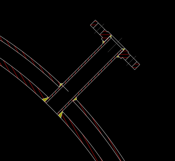

can i provide only groove without fillet in nozzle to shell connection?
FIG. UW-16 gives attachment with fillet.
ASME SEC VIII DIV 1
NO.
Fillet welds shall be added where necessary to reduce stress concentration.

yes r6155...In this case the fillet weld to the outside of shell is not possible due to jacket around the shell.(because the nozzle will attached after jacket setup. so we have to weld from inside of vessel shell only.)
can i provide fillet with the some inside projection?
can i use fig.uw-16 for inside projection? is it applicable?
Better is a drawing.

Since this is not a standard fitting, I believe UW-16(e) would apply up to NPS 6, which may be welded from inside or outside only.
As I recall, there are particular rules for nozzle reinforcement in jacketed vessels, may or may not apply to the OPs query. Apx 9 I believe.

this is the case
this is standard 50DN NOZZLE..
vessel have 200 DN Nozzle too..where UW-16(e) Iis not applicable
Well, your design is ok.

dear r6155, how do i justify that fillet weld is not required or not mandatory for fig UW-16(c) to A.I. ?
Probably also worth stating that UW-16.1 only provides some acceptable types of connections, it doesn't exclude other types of welded connections not explicitly listed. There is no detail provided for a shell connection through a jacket. Appendix 9, 9-6 would only refer back to U-2(g) IMO, whereby the above approach may be suitable.
See Figure UW-19.1 (e).
Fillet welding is for a smooth transition or for reinforcement. None of them are necessary in this case.
