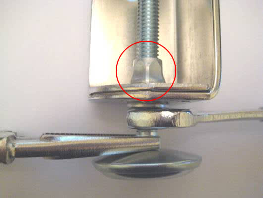

Hi, I'm looking for the type of nut used in the attached image of levelling legs (in the red circle).
Many thanks, Dean

It kind of looks like a rivet nut. Is it fixed in place? Was it inserted from the side where the wrench is located and expanded into place?
Kyle
Thanks to all. This is a stock photo, it's not mine, I am looking for this nut, yes 4 of them - M8.

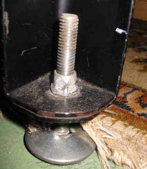

I had gotten to full hex rivnut by searching, but was under the impression this one does not have a straight body as hex do. Maybe it's the angle of shooting. Also this one is short compared to other hex rivnuts. Here's another stock image of the same type, they appear kind of standard.

I think you are possibly misunderstanding the rivnut; it starts out with a longer body and the riveting action shortens it to what you see in the photo. The one in the photo was probably close to 1/4" longer before it was riveted. Here's a cross-sectional view from the manufacturer's website

If the nut in question is a hex head rivet nut, then perhaps this one could be a replacement:
Or as Mike mentioned:
If you drill out the old Rivet Nut (if there), then you have the option of using a replacement Hex Rivet Nut or two back-to-back Hex Flange Nuts, as already referenced.
Walt
Had indeed skipped the riveting part, that does it.
Hex rivnut it is then. The ones over at rivetnutusa.com appear ideal.
Thanks to all for contributing.
