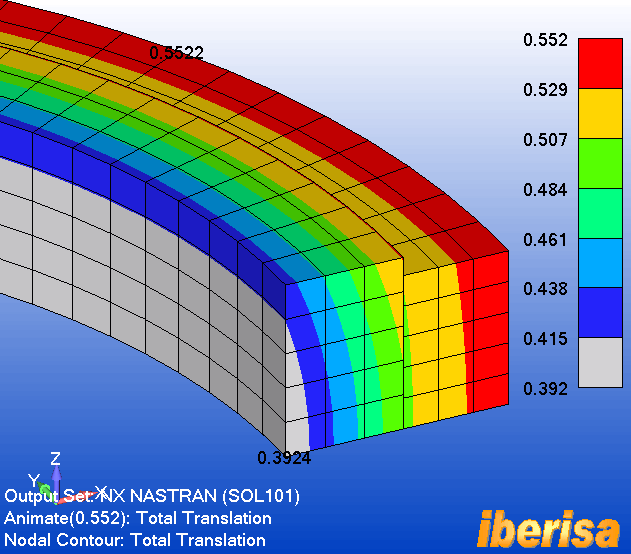

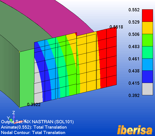

Make sure the mesh is exactly symmetric. Also, you can solve the problem fully in 3-D using CHEXA 8-nodes brick elements, or in 2-D using 2-D Solid axisymmetric CQUADX4 four-node elements, the results should be exactly the same, but at a reduced cost, see two examples in the next animations of the contact between two cylindrical solids of different materials under an expansive thermal load of nodal temperature:
• In the first example a 3-D surface-to-surface linear contact "no penentration" is used.
• In the second model a 2-D edge-to-edge axisymmetric linear contact "no penetration" is used.
• Both models are solved using Simcenter Nastran linear static (SOL101).
