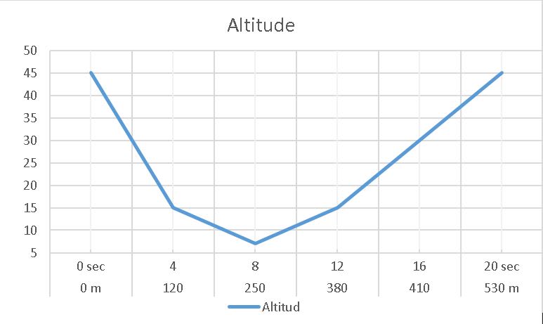

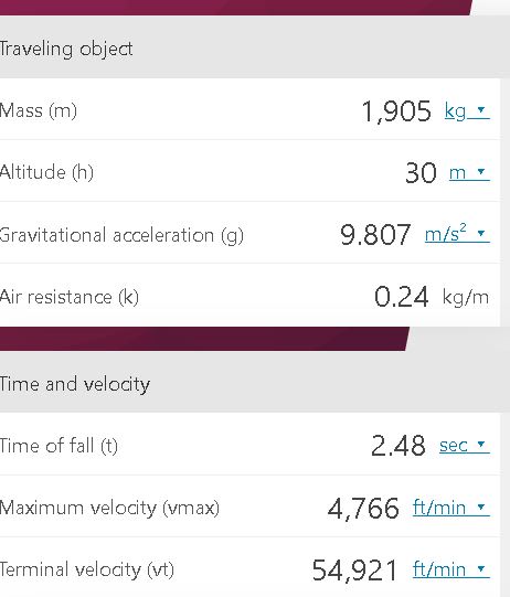

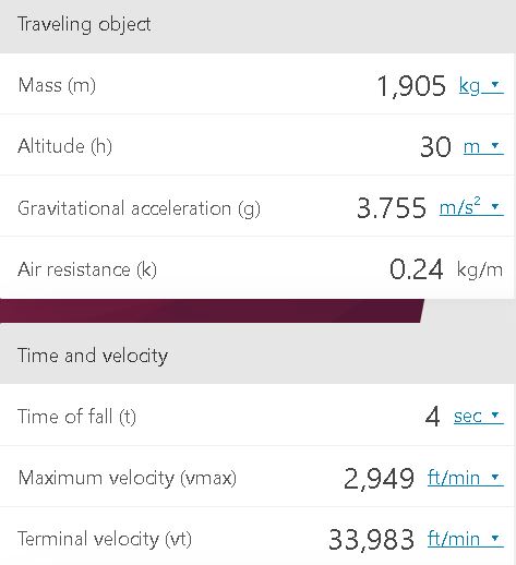

What I was thinking about was.
If the plane falls 30 m in 4 seconds at angel 14 degrees and a little more before he managed to catch up.
I think the plane must have stalled..
In that movie where they practice spins, it takes about 5-6 sec before he manages to start getting upp again .
Do not know of course, how far the plane had fallen then?
But something that falls in free fall, falls 30 m in 2.5 sec.
The manual states that the plane can fall in the worst case 90 m, 300 feet in a stall.
And the plane also changes course a bit to the left in this point 12:06:38.
So is this a "normal" stall "forward" or not ?
Best regards Anna

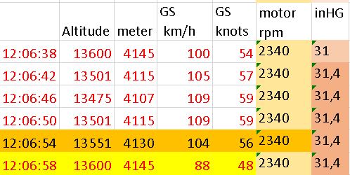

But if I am now going to speculate, then can anyone tell me if any of the following statements, read assumptions are completely up the walls?
• The plane stalls "forward" about 14:06:38
• And turns slightly to the left.
• The angle of the aircraft is the first 4 seconds about 14 degrees nose down.
• The plane falls 30 meters in 4 seconds.
• And then 8 more before it flattens out.
• To raise the stall, pull the "steering wheel" towards you, to get the elevetor max up, to reduce the nose down and get the nose up until the plane flattens out.
• Then the pilot recovers from the stall about 14:06:46 and then comes up to the height again (4145m) at 14:06:54.
• 14 degrees is not a "giant" slope downwards, but since the jumpers sit with their backs in the direction of travel, it is difficult to "stay" in place.
• Those sitting at the back may have moved a little forward when the plane puts its nose down 14 degrees.
• When the pilot recovers the stall and the plane is on its way up again about 7 degrees nos up, it is easier to stay in the same position because you can hold on with your feet and hands, so not to slide backwards again.
• Which may have meant that the plane's center ogf gravity was a little further back before this stall than it was after at 14:06:54 (The center of gravity was moved a bit forward).
• If the plane has just come out of a stall, it is more natural for the pilot to tell the jumpers to move forward.
• Or that the jumpers themselves move forward because that is what they "think" they should do after other instructions after stall warnings.
• That the jumpers would not start moving backwards again directly after the stall was recovered and the plane reached it's height again.
Feel free to comment ..

Thing is a 30 meter drop in 8 seconds isn't that much or in fact unusual.
Its about 700-800ft per min which is what we do as standard while doing a 3 degree approach to land. During a stall I would expect 2-3000ft per min decent rates, Which even then are not that unusual I was doing 4500 ft/min yesterday to help air traffic out separating us against an outbound.
I have never hit he elevator max stop. The only time I could even imagine being able to do it in the air is during a spin when it has no load on it. And as a flying instructor we were doing stalling every week at least once spinning monthly.
According to CP and SHK, this is done at every single landing?
Just before touch down?
I have also seen it on film but thats besides the point here.
The first 4 second where 30 m 14 degrees.
Since the secondary radar only pings every 4 seconds, the curve should be rounder and the angle probably steeper at the beginning.
That plane is, as I understand it quit slow and dosile.
So if he haden't recovered it in time you would have hade a max velosity 3000 feet/min.
Or?
Free fall
Fall in 4 seconds.
