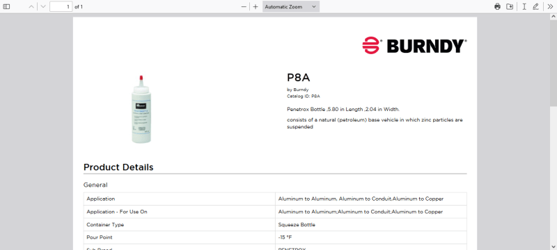

New product to increase electrical contact

I have always had good luck with Penetroxtm.
It contains zinc particles to cut through the oxide layer, based in a grease to seal against air and moisture.
Good practice with aluminum is to wire brush the surface and immediately apply a coating of Penatrox.
Aluminum oxidizes almost immediately so the compound must be applied immediately after wire brushing, not after the coffee break.
Not for use on moving switch contacts due to the abrasive quality.
[link Full Page of Specs][/url]
