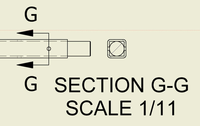

Can I get someone to point me in the right direction? Here is my problem. I have a driveshaft that is inserted into a square tube and than plug welded perpendicular to the axis. I was wondering if someone knew of a formula to help predict this(torque/stress)? Currently there is no documentation on our current process and I'd like to better document it for any future changes.

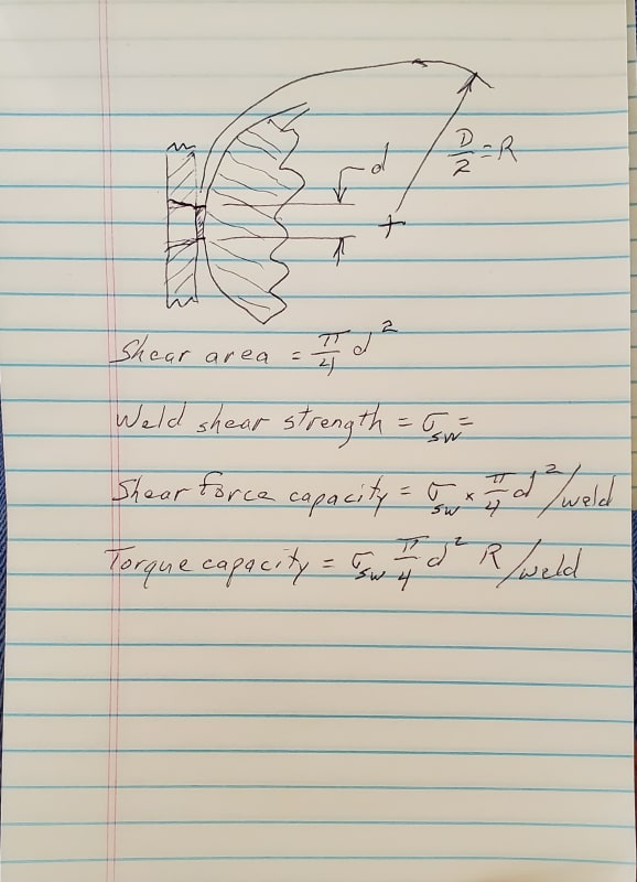

If you know the section area of the weld and the shear strength of the material then it's going to be
shear area)*(shear strength/unit area)*radius = resistance to torque before it shears.
I would use a good size factor of safety; more if this is a cyclical load that can produce fatigue (or use the fatigue limit for the shear strength/unit area. You say a drive shaft, so that sounds like a cyclical load that will produce fatigue. It may be worse if there is also misalignment that produces bending, but a shaft coupling like a u-joint can lower that additional load.

Apologies for being thick here, but can you define where exactly the weld is please.
Does "plug weld" mean you weld inside that little hole welding the shaft to the square tube??

Alright let me clarify a few questions up.
1. It can't be machined due to cost, to cut the flats are unrealistic due to it being over 132"lg and the extra mass won't be liked by our motor/drives. Our volume is too high for a machined solution.
2. This is a design with legacy, I don't like it either. The welding process reeks havoc on the shaft runout.
3. A sprocket is placed on this that requires the square profile, it goes every few inches down the shaft.
4. Currently our largest gearmotor can put out 7612 in/lb. The min dia for the sprocket is Ø2.25", tubing is 2.5"sq, rod is Ø2".

Build a few samples of the joint. There is no need to build a full shaft. Test to failure. Inline dynamometers can be rented and a chain or lever hoist (also rentable) can be used to generate the force.
OK - so is the round shaft 132 inches long and you are pushing that into a square tube that is close to 100 inches long to add a square section for the sprockets? And then there are a large number of plug welds along the length of the two?

If you've got a design that works (legacy design) then maybe that's a way to calibrate your design eye-ball.
If you need more substantiation these days, then testing is the easiest route.

However, the picture in the first post shows 2 holes on opposite sides, and there might be multiple instances of that section asking the length.
