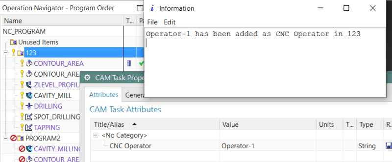

I need help in NX CAM, is there any sample on how to set Attribute into parent program group(.Net vbscript) without typing/filling the form.
What I want to add the attribute:
attribute name: CNC Operator
Value: Operator-1
Type:String
At the end of the journal running, there is the information verified in listing window:
"Operator-1 has been added as CNC Operator"
Somebody share any help with this case, I very much appreciate.
Regards,
Maryadi

If I understand this code below can help you
Code:
Option Strict Off
Imports System
Imports NXOpen
Module NXJournal
    Sub Main (ByVal args() As String)
        Dim theSession As NXOpen.Session = NXOpen.Session.GetSession()
        Dim workPart As NXOpen.Part = theSession.Parts.Work
        Dim lw As ListingWindow       = theSession.ListingWindow
        lw.Open()
        Dim Attributename As String = "CNC Operator"
        Dim Attributeval  As String = "Operator-1"
        Try
            Dim nCGroup1 As NXOpen.CAM.NCGroup = CType(workPart.CAMSetup.CAMGroupCollection.FindObject("PROGRAM"), NXOpen.CAM.NCGroup)
            nCGroup1.SetUserAttribute(Attributename, -1, Attributeval, Update.Option.Now)
            lw.Writeline(Attributeval & " has been added as " & Attributename)
        Catch ex As NXOpen.NXException
            lw.Writeline(ex.ToString())
        End Try
    End Sub
End Module

nxexplorer said:
I think this because the Program Group Name is not "PROGRAM".
You are right
Try this
Code:
Option Strict Off
Imports System
Imports NXOpen
Imports NXOpen.UF
Imports NXOpen.Utilities
Module NXJournal
        Dim ufs As UFSession             = UFSession.GetUFSession()
        Dim theUI As UI                  = UI.GetUI()
        lw.Open()
        Dim selectedCount As Integer = 0
	Dim selectedTags As Tag()    = Nothing
        Dim type As Integer
        Dim subtype As Integer
        Try
            ufs.UiOnt.AskSelectedNodes(selectedCount, selectedTags)
            If selectedCount = 0 Then
                theUI.NXMessageBox.Show("Error : ", _
                                        NXMessageBox.DialogType.Error, _
                                        "No CAM node selected...exit")
                Exit Sub
            End If
            For i As Integer = 0 To selectedCount - 1
                ufs.Obj.AskTypeAndSubtype(selectedTags(i), type, subtype)
                If type = 121 Then 'Program group
                    Dim nCGroup1 As NXOpen.CAM.NCGroup = NXObjectManager.Get(selectedTags(i))
                    lw.Writeline(Attributeval & " has been added as " & Attributename & " in " & nCGroup1.name())
                End If
            Next
        End Try
    End Sub
End Module
Hi UserCFAO,
It is works perfect! That is what I hope. The main purpose from this journal as now, the user want to change UDE procedure with an attribute. Now I will guide them on how to connect it into post builder and OWI.
I very much appreciate yours with this sharing.
