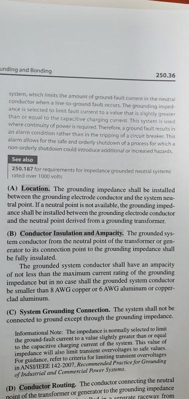

Dear che12345...I am thinking on similar lines. I am attaching the handbook excerpt of NEC Sec 250.36 which deals with high impedance system. The clear requirement is for ground fault detection (as earlier mentioned by me). The presence of equipment bonding jumper (with mention of equipment grounding conductor) in 250.36 (E) does obliqely mean that EGC needs to be installed. But the figure does not show the same. Unlike 250.32(B) Grounded system and 250.32(C) Ungrounded system, there is no direct reference to EGC in 250.36. I am almost certain that high impedance systems do not require EGC. The detection system using a CBCT and ground fault relay, which can be set pretty low, suffices the condictions. The equipment will ofocurse be locally grounded to the buried ground grid.
Dear Kiribanda: Only limiting our discussion to (1) for industrial setup, ofcourse the ground fault current will be limited to 10A or less since there is no other path for the return current. You can easily calculate the L-G fault current using the basic equation : V / {(Z1+Z2+Z0) + 3Zn}. Here the only difference is that the return path, instead of a lower impedance of EGC will now see the buried grounding system impedamce which wil be in the order of 1 ohm to 3 ohms. This will drive the current lower than 10A, but should be easily detectable by CBCT and senstive ground fault relay of the faulted feeder.
Another point to be noticed, Sec 250.187 which deals with High impedance systems for greater than 1000V, clearly identifies Equipment Grounding conductor in Sec 250.187 (D). But any such EGC reference is not there in Sec 250.36 (A) to (G). I rest my case.
