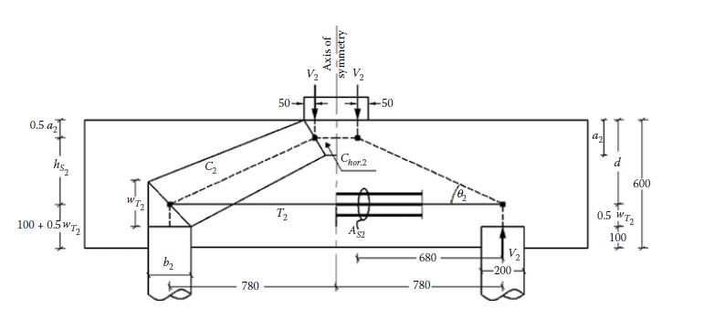

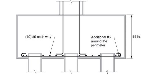

Dear Engineers,
Please see the following and provide your valuable response. Thanks.
