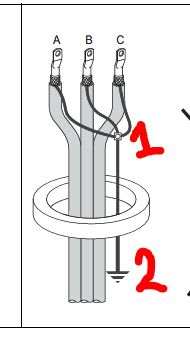

One problem with core balance CT installations on medium voltage cable is that the shields go through the CT as part of the cable assembly and then don't come back after they're separated at the terminations. They have to come back through the CT and then be bonded to ground. If they only go through once, any current on the shields can cause the trip, even with no current in the phase conductors. Energization of the main transformer could be causing changes in ground potential, resulting in the shield currents.
@davidbeach
The installation was performed as described in your post:
Point one was connected through an insulator to the earthing bar of the cable compartment (no electrical connection), passed through the core balance CT and then terminated at the earthing bar of the cable compartment (point two).
Nevertheless I have seen I0 measuring 0.1 - 0.2 Amps during normal loading of the transformers but I blamed in at the magnetizing current and the low power of the transformer (50 kVA at 20 kV is 1.5 A).

I will stand with my previous insight. When you energize the main transformer T1, the spill over current (3I0)
generated due to possible CT mismatch, will pass through Point # 2 of the shield earthing of CBCT of Aux Transformer
and trips its 3I0 protection. Because they are in very close proximity.
So you have to temporary disconnect the Point # 2 and isolate it properly from all earthing points, and then
re-energize the main transformer to verify whether 3I0 of Aux. transformer is still working or not.
