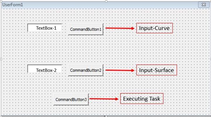

I got answer for my previous question that is how to select multiple inputs at a time. But, Now I have another question how to count user input selection?
I want to know how to count user input selection? I have three command box in my Userform and command box 1 & 2 for user input selection(Single input selection at a time) and command box 3 for executing some process.
After first execution the cycle will repeat. Once first execution is done, Command box 2 input will get automatically select and user has to select input for command box 1 only and this cycle will routine. I want to count how many times command box 1 input is selected? Please guide me how to do this? Please refer the attached image.
Note:Command Box 1 Input is "Curve" and Command Box 2 Input is "Surface".

Not really as you didn't provide any "Please refer the attached image." thing.
I would also like to see some related code.
Sorry! Attachment was not attached. I have again attached image.
As I have mentioned in the previous mail, I need to count user input selection on Input box-1.
I am trying to automate sweep option and writing coding for same. To automate sweep user has to give two inputs one is curve and another one is surface on which sweep will be created.
During first execution user has to select two inputs(Curve and Surface). Without closing GUI, user continue to create second sweep just by selecting curve Input and surface Input for input box-2 will get automatically select from the first execution. Now I need to count how many times curve input is getting selected?? Please refer the attached image.
If I want to simply say how to count input selection(Select Element 2)by loop??
Code:
Private mClickCount as Integer
Sub Class_Initialize()
  mClickCount = 0
End Sub
Private Sub CommandButton2_Click()
  mClickCount = mClickCount + 1
end sub
Thank You! I tried and it is working.
