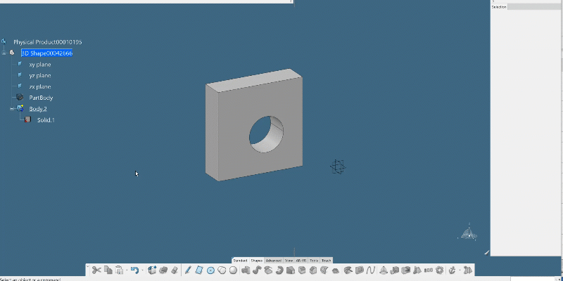

Good morning,
How could I move an unparameterized feature (the yellow hole, in this case)?
Let's say, moving 10 mm on the direction of the red arrow...…..
Thank you!

Hi
U should put a tree of your part on this picture.
R
two options:
-on the dead solid, use remove face and click on the yellow hole. Create a new whole with your requirements
-if you have part design feature recognition workbench, run the automatic/manual hole recognition--change hole sketch to your positional requirements
regards,
LWolf
LWolf,
I was an NX user.
In NX one could move an unparametrized feature easily.
I thought that Catia has something similar.....
Thanks for your reply!

Itsmyjob,
Thanks for your reply, that's exactly what I was searching for!
How could I get this feature?
CAD 2015
talk to DS or your VAR

Eric, V5 or 3DX?
regards,
LWolf
i m using 3dx , you check about v5
