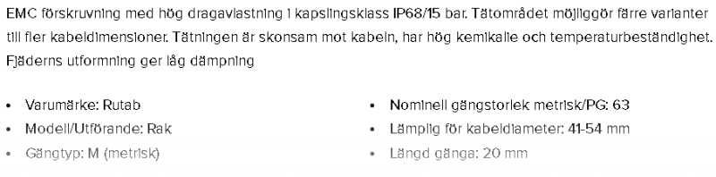

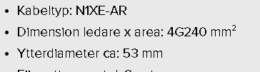

An example of a cable outer diameter cable 53 mm up to 54 mm for some.

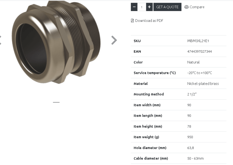

And this is a M63 cable gland it takes a cable diameter 42-54 mm
But I also see in the drawing that it says 2'1/2 which would give you 50-63 mm with this one

Yes apparently they use single core and not multicore for the motor cables
