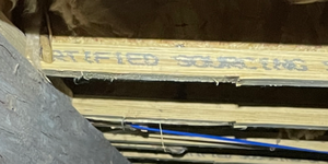

This is an 8 ft. span, 3 1/2x9 1/4 beam in the crawlspace of a 2 year old home. It supports 12 ft. trib of floor framing (trussed roof). There are some cracks in the sheetrock near this beam.
1) What material is this? It looks like crap. It appears to be one 3 1/2" wide ply. Kinda looks like an LVL. Could it be LSL? It has no markings.
2) The beam appears to have slight sagging in each span. I did not have a stringline with me, however.
3) It also appears to be crushed slightly at the edge of each support.
No way this should be sagging at this span with only 12 ft. of mostly floor dead load.
My guess is that it was put up soaking wet which temporarily weakened it and it has shrunk a bit as well.
The owner states the cracks have not worsened in a year.
Thoughts?

It appears to me to be an LVL that sat out in the weather for a long time. I don't believe it's PSL.
I thought so too but it appears to be a solid 3 1/2" wide - something I have never seen in an LVL.
There are some wider LVL's out there.
That's almost certainly a PSL. LVL would have straight lines on the bottom where the veneers are glued together. The photo from XR shows strands.
And that coloring is very typical of aged PSL beams.
There are companies that sell LVL in 3.5" or 5.25" widths. But they're not common.
Another thought or 2 to add -
The crushing at the support puzzled me. I'm wondering if the builder maybe used a machine to set a bunk of plywood on that area. Or maybe wall framing material after the subfloor was on. That would explain the crushing.
If the LVL was soaking wet when the house was built, it may have slowly dried out and shrunk. (They change a lot in size with changes in moisture) That would explain the drywall cracks, as you mentioned in the OP.

There is nothing wrong with those piers.
The quality of construction gives me clues about the cause. From the quality of those piers I expect that there is one bag of sakcrete under them, therefore, no pad. For 6 kips you likely have differential settlement of the pier relative to the continuous wall footing.
I don't think that there is anything wrong with that PSL that I can see in your photos, just some superficial weathering (you can even see undiscolored areas from under the banding from where this beam sat exposed on a pallet).
People saying this is a hand-hewn timber not a PSL have likely not handled either one in person.
I disagree. As much as I do not like production builders, in my experience, they do not skimp on pier footings and they are inspected by the AHJ. They would never use Sakrete unless they simply forgot a footing and were adding it after the fact.
Then you might have to get back out there with a laser or string line. Even if there is a pad you may have differential settlement. I'd probably stick a crack gauge on the wall and have the owner monitor it for a few months. If no further movement just patch it.
You have a lot more faith in contractors and BD inspectors than I do.
The owner already stated that the cracks have not changed in a year.
I'm sticking with shrinkage.

The PLS beam appears weathered where the I-joists look like new. My guess is the beam was exposed to the weather prior to installing the I-joists. Engineered beams can’t take much water before dry rot starts to damage the beam. Sagging and crushing over the supports are usually a sign of dry rot. Did you take a screw driver or pick to look for soft spots in the beam.
