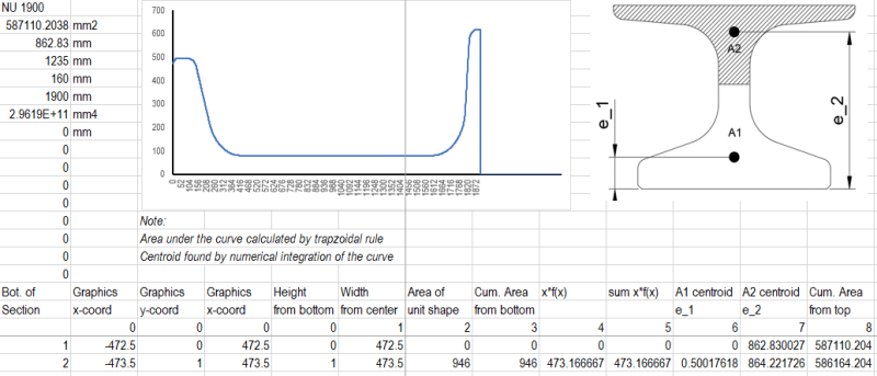

3) My current approach is to transform the width of the deck slab by n = Ec,g / Ec,s (like what you would do in a steel-concrete composite beam), and then assuming f'c = 50MPa in all my calculations.
Unfortunately my company doesn't have software to do pretensioned beam design so I am unable to verify my calculations with a computer program. Any advice/literature on this is appreciated.

Have a look at Eurocode 2, equation 3.1.7 (1) and 3.1.7 (2). Therein, a description of the concrete compressive stress as a function of strain is given. Using this compressive stress block, you can find the resultant concrete compressive force by numerically integrating (e.g., in Excel, using the trapezoidal formula) the stress, multiplied by width, multiplied by the differential. Formally:
F_comp_resultant = integral (sigma(y)*b(y)*dx)
, where dx = step-size , b(y) = width as a function of height (this can be given as discrete values in your excel table), sigma(y) = stress, and y = vertical location in the cross-section (above the neutral axis, of course). For the step-size, you can use e.g., 40 points, defined using the distance from N.A. to the upper fiber: "dx = (upper_fiber - N_A) / 40 ".
To find the resultant of the concrete compressive block, re-do the previous calculation, but now add a lever arm to the centroid (measured from the N.A.) of each "small increment of force" and subtract this result from the distance to the N.A. (in your notation, that is "c"):
a = c - integral (sigma(y)*b(y)*y*dx)
To find the internal lever arm (where d = effective depth), calculate:
z = d - a
Googling "numerical integration of concrete compressive block", or something to that tune, may help in clarifying what I attempted to describe.
Your bridge girder and deck form a "T-beam", and since you said that the N.A. is in the girder web, you need to use superposition to acquire correct results. Simply integrating the whole section is not possible, because there is a discontinuity in stress-strain at the deck slab/girder interface.
First calculate the moment capacity (force resultant, its location and the lever arm) for the girder (everything below the deck slab). Then, calculate the moment capacity for the deck above the girder. Then, calculate the moment capacity for the part of the deck located to the right and left of the girder ("outstand flanges" so to speak). To account for different concrete strengths, use "fc = 30 MPa" for the girder web calculations and "fc = 50MPa" for the deck calculations.

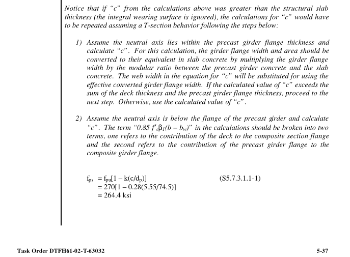

After I posted, I did find some information from a prestressed concrete design example from FHWA regarding the different concrete strengths. However, your method seems to be the correct way of looking at this problem.
The picture you posted details the T-beam design concept, and the modular ratio-approach (culminating in transforming girder flange/deck slab into a homogeneous section) does seem to be one way to account for the varying concrete strength. I recommend to verify this by further research and/or by asking a senior engineer for advice. Also, please note that the T-beam discussed in that document appears to be rectangular (rectangular web, rectangular flange and rectangular deck slab), and the equations may therefore not be directly applicable for your design.

PS. You can easily find the width as a function of height (b(y)) by using AutoCAD or other drafting software. Determine the neutral axis, discretize the compressive block (e.g., into 40 "slices"), measure the average width of each "slice" and input these values into Excel or similar software. Furthermore, locating the force resultant does not necessarily require numerical integration if you integrate from "e_c = 0%" to "e_cu=0.35%", since it results in compressive blocks with known centroids (semi-parabola and rectangle or triangle and rectangle, depending on the stress-strain material law you choose to use) which you can then utilize, e.g., "M_capacity_total = (d-centroid_semiparabola)*force_semiparabola + (d-centroid_rectangle)*force_rectangle", where the centroid distance is measured from the extreme compressive fiber and "d" is the effective depth.
After checking out EC2 1992-1-1, I do agree with your approach and will start working on integrating that into my spreadsheet. Fortunately, my spreadsheet was already doing numerical integration for areas and centroids so adding in the stress calculation at each slice shouldn't be a big modification. My senior engineer is always busy but I definitely should go talk to him [bigsmile]. Thank you again for your help!
