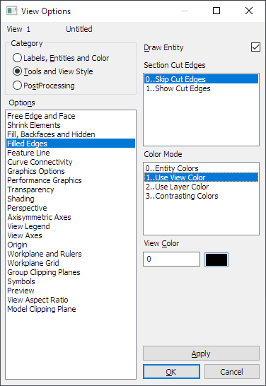

Press F6 and find this option. You can change edge color from contrasting to View color and select one color for all edges you want.
