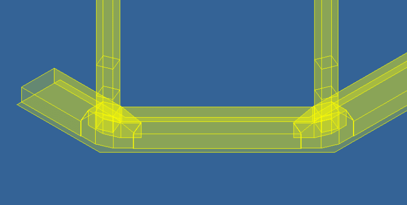

So my job is to model a hopper bottom silo with non-linear FEA with loads calculated as per EN 1993-4-1, and optimize the components to reduce material costs. The hopper/silo is supported the last few meters by legs. I'm new to the industry and happy for advice and suggestions. This is what the base looks in my mid-surface model:

This sounds like an extremely complex task and best approached by looking at very specific areas at a time. Your model seems to indicate that you have hollow section columns and no lateral bracing which is quite a surprising design. Is this actually how the silos you are dealing with are designed?
Back to your original question. I would be modelling the surface contacts as a stiff foundation, though typically you'd consider pinned connections to the foundation. Silo foundations are generally very rigid due to size require to both spread the load and simply to resist overturning from wind when empty.
