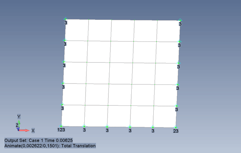

I am carrying out some FE modelling o plate using simply-supported along three edges. I am wondering how I could go about applying boundary conditions on the FE software, preferably Strand7. The scenario is that the plate is subjected to uniformly distributed load on its face and I need to investigate the maximum tension and deflection for varying loads. all replies are welcome. appreciate it

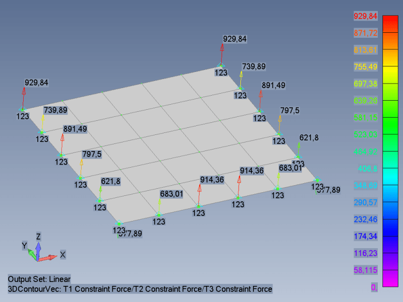

I am not a Strand7 but I assume that you can and know how to fix any of 6 DOFs in any particular node in your mesh. Than you should use 3-2-1 method to apply additional support to model.
Here is an example, plate located in XY plane and pressure is applied normal to plane. Numbers near nodes are fixed DOFs 1/2/3/4/5/6 -> TX/TY/TZ/RX/RY/RZ.
As you can see plate edges can move free in XY plane.
1-Constrain edge translation in vertical axis only. (If required)With additional constraint of one of the corner in both lateral direction to avoid rigid body motion. All rotations free.
2-Another "complex" but more accurate approach would be to define support surface below plate edges and define contact between support surface and plate with frictional/frictionless contact just like it will be actually supported. Note that support surface needs to be optimum width to avoid slipping of edges from contact due to low width or large part of plate surface getting supported.
Considering contact convergence hassle and other time consuming activities, option 1 looks easy and quick fix.[bigsmile]

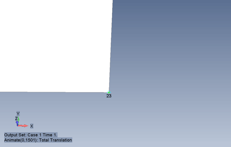

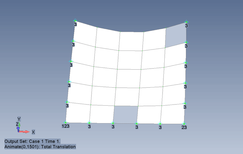

I'm a little bit surprised that the lower right node is not moving in x, but I suppose that is because it is a linear analysis. I am very surprised that the upper corners move apart.
That is, take a matchbox tray, rip one end off. Put your finger in the middle of the free edge, The sides will move inwards, never outwards, doesn't matter which way vertically you push. Perhaps we are looking at an animator artefact.

It moves, here is zoomed view.

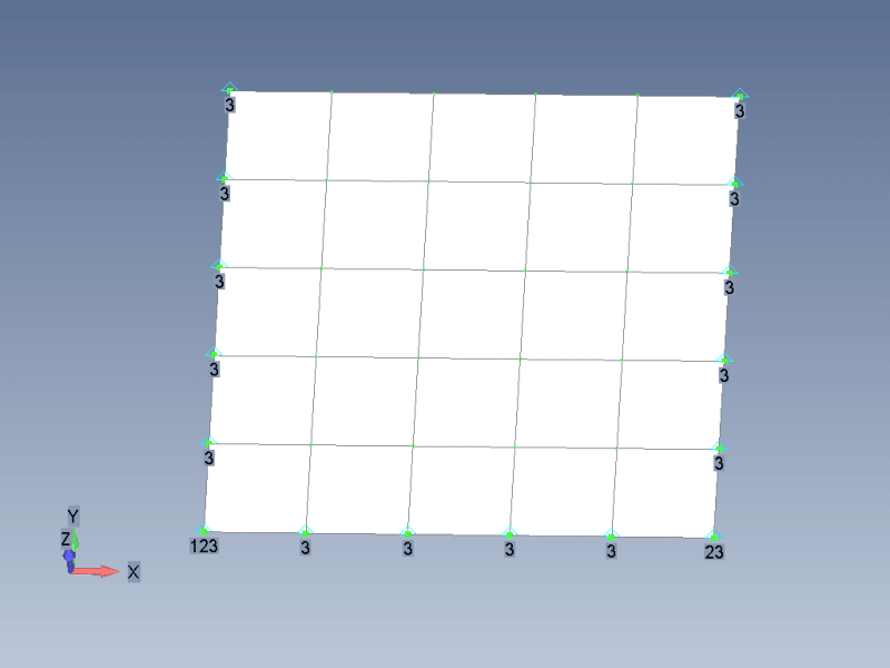

I made nonlinear analysis (SOL106, Nastran) with geometric nonlinearity.
Yep, that`s what I get when use animated view with setting Linear-Full in Femap. Here is better animation with intermediate nonlinear results.

In linear - no.
In nonlinear you will capture additional tension of plate and get non vertical constraint force components.
With respect to the upper corners moving apart: yes, that is indeed a common animation artefact that you'll often see when linear solutions are animated from -1 to +1 times the applied load.
The animation routine has only two sets of actual displacements to work with: zero load / zero deflection; and applied load case / resulting deformations. The deflections are generally amplified (by a factor of 100 or so) to aid visualisation. The animation routine may then generate another "negative" displaced shape using -1 times the calculated deformations, to approximately simulate a negative load application, as well as a number of intermediate steps to cycle through.
In a case like this, if you actually analysed a negative load case, you would find the upper corners both move inwards, just like the load case which has been analysed. However, the animation routine shows the upper nodes moving outwards by an equal and opposite amount to how much they were calculated to move for the positive load case.
If you only animate from zero load to applied load, you won't see this spurious behaviour - it is only apparent when animating from -1 to +1 times the applied loads.
