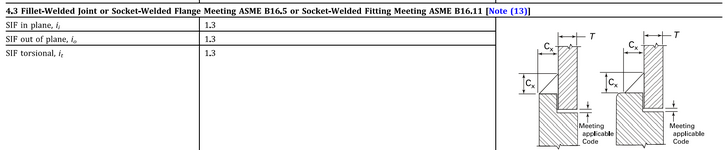

Just don't forget to enable SIFs for socket welds as per ASME B31J (if applicable to your code):
