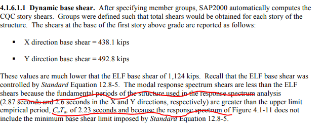

I've got a question regarding 12.9.4.1 of ASCE 7-10:
For example lets, lets say i've got my building whose first 2 modes are translational x and y modes that are in the range of 2 seconds. I go ahead an calculate my capped max period for ELFP, Ta = 0.8s per 12.8.7.
Then reading 12.9.4.1, with CuTa = 0.8*(1.6) = 1.28s, it states "where the calculated fundamental period exceeds CuTa in a given direction, CuTa shall be used in liue of T in that direction". Does this mean that I have to fake my response spectrum curve in my analysis to be "capped" at the acceleration that would occur at a period of 1.28s? see below for the curve I would anticipate to input "faked" curve (replace Cs with a%g) forcing a higher MRSA acceleration at longer periods.
This is how I read this code snip, but examples from FEMA do not seem to agree with this conclusion.

Per 12.9.1.4.1 (Scaling of forces) the CuTa is used in the procedures of 12.8 (equivalent lateral force method). It doesn't affect Vt (the modal base shears), rather it affects the V value (ELF base shears). Then you use V/Vt to scale up the modal results where necessary.
Stated another way, this provision is a way to scale the response spectra results so that the base shear cannot be less than you'd get from the equivalent lateral force method.

What you said was my old way of thinking as well.
It seems odd to me to even include the line of:
Why not just leave it at saying scale the forces to 85% of ELFP?
