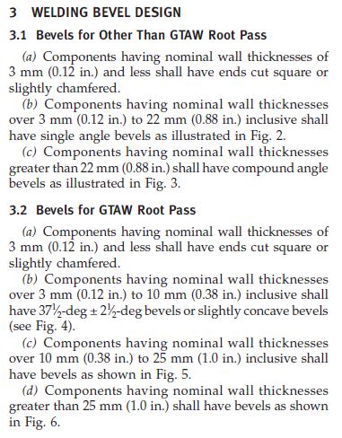

ARUN SIVAN,
I'm not sure where you are from, but perhaps you should get a copy of ASME B16.25 "Buttwelding Ends". It would probably help you answer some of your questions. See below for a short excerpt.
"The only limits in life are those which we impose upon ourselves."
I watch our customers butt weld 2" x 0.028" tubing regularly, because their code allows it.
It is all about following the rules.
The smallest butt weld thickness that we qualified was 0.030" only because that was the thinnest thickness that was specified under the Engineering design per the applicable Code and this was a manually made weld (by extremely talented welders). I have seen butt welds made in much thinner tubing with automated equipment.
Thank you all for valuable replies.I cleared in my doubt.
