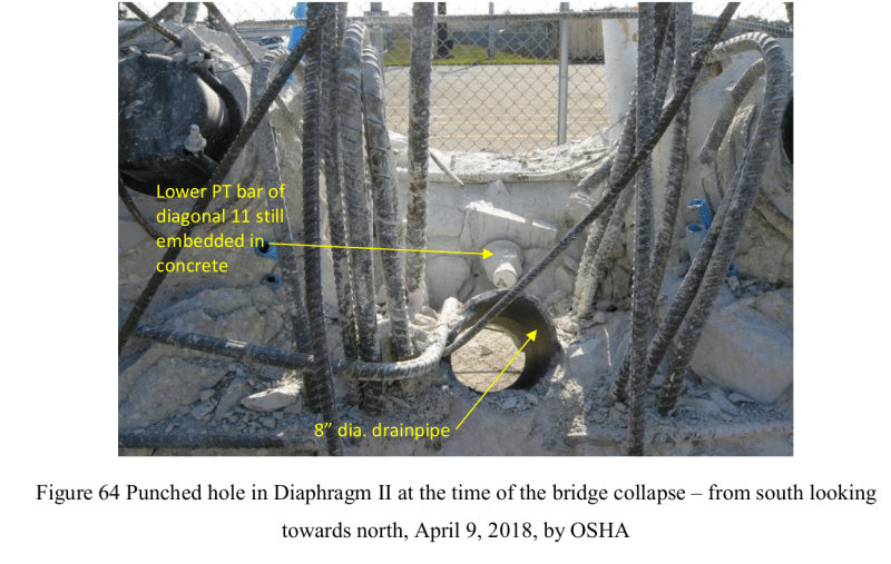

Sym P. le (Mechanical) said:
I do not submit to the fallacy of a concrete blowout.
In reinforced concrete a blow-out is a loose term. Generally it means when a part of the reinforced concrete under a very stress suddenly fails the local concrete is crushed into small pieces and disintegrated after the collapse.
OSHA is an officially appointed and professionally qualified investigator in the FIU bridge collapse and the word blow-out has been used in the report text five times and in the description figures also five times. NTSB used the word blowout also four times in the text and one time in the figure description. Thus the word blow-out or blowout would be the opinion of an expert witness in court and one I would concur based on having worked all my life with reinforced conceret. Thus I am sure it isn't a fallacy.
Comparing your figure posted on 1 Jul 20 17:57 with OSHA Fig 64 below (or any of Fig 58 to 70) your ultimate failure plane is nowhere near to what had happened on the bridge.
The bottom of 12 failed because the weakest plane, where the stress is the highest when the cross ection is the smallest, is at the 8" PVC drain and not somehwere above it where Member 12 still has a full cross section. The OSHA Fig 58 to 70 inclusively show no concrete above the 8" drain after the collapse.
The elastic mudular ratio between concrete and PVC is about 15:1 so the 8" PVC pipe could take hardy any laod. If both deflect by the same amount the PVC takes only 1/16 of the load when both have the same area. However the overall 8.6" OD PVC drain caused a 41% reduction in the 21" thickness of Member 12. As the drain pipe situated at the middle so the reduced section is split into two 6.2" thick pieces on either side of the PVC drain. Do you still think the 21" thick concrete is easier to break than two 6.2" sections when under the same load?

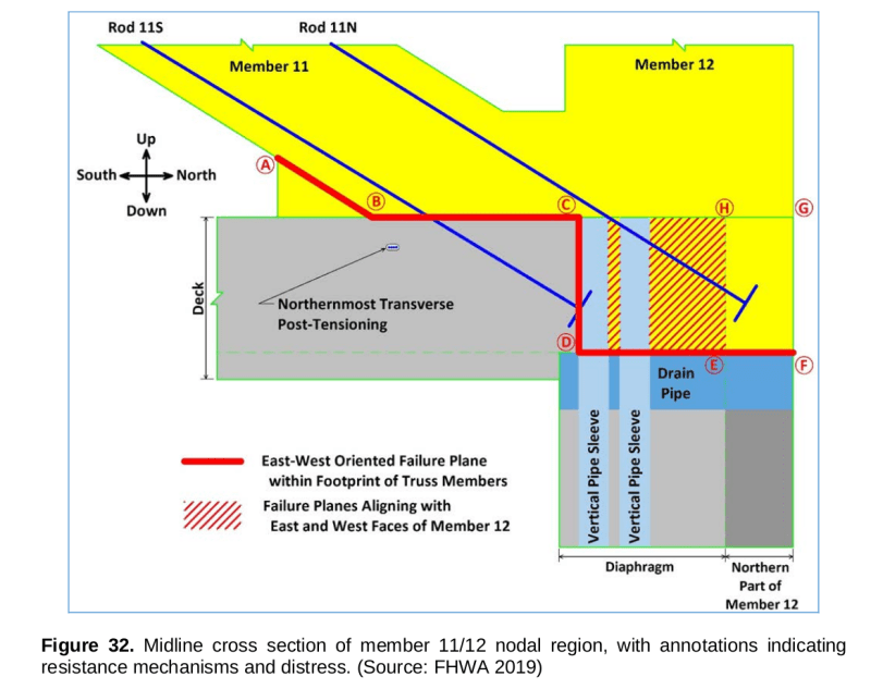

Lastly I like to re-post NTSB's Fig 32 below as this is the official failure plane concluded by NTSB and it matches all the post collapse photos. Any attempt to re-write the history or the offical verdict should be supported with similar rigorous analysis and investigation. Merely a personal opinion on something else not backed by proof is not a contribution to our understanding of what has really happened.

Hi Saikee, much appreciated. But I have a question. Because failure is a three dimensional event, there must also be a vertical failure plane. Your excellent diagram shows only a failure plane in a horizontal plane - red line extending in an out of the page to form a horizontal plane. Can you clarify ? Many thanks.
FortyYearsExperience (Structural)
With reference to NTSB Fig 32
Along the South to North direction
The failure section has A-B-C and D-E-F in horizontall direction. A-B-C failed by shear but D-E-F was likely by bond failure as the none of the reinforcement (2x#11+8x#7 on East and then on West face) failed by shear. The vertical plane C-D failed by tension. In reinforced concrete design concrete is assumed no tensile resistance in design and a small amount in analysis.
Along the East to West direction (East being Fig 32 while West is the back side of 11/12)
The deck is physically attached to 11/12 via area C-D-E-H-C but the two 4" dia vertical pipe sleeves destroyed part of the bonding or shearing area. What was left has been indicated by the hatched area and there are two sides both of which failed by shear.
