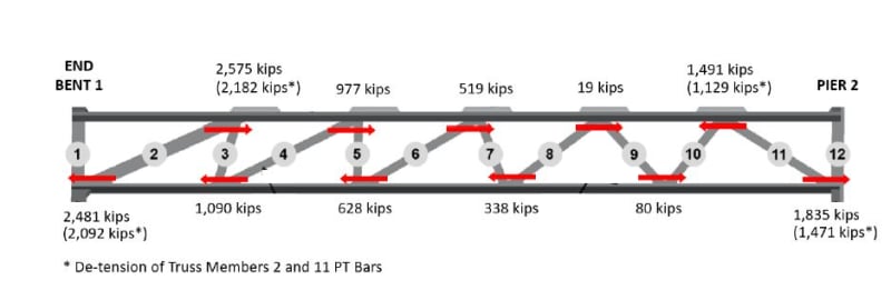

Ok, here's something that has puzzled me for a long time on this bridge.
The picture below shows, to me at least, a large discrepancy in resisting forces on the top and bottom chords.
I.e. the top chord has a lot more force going right and the bottom a lot more going left. In a classic truss design these forces are roughly equal.
But here we have large discrepancies (about 2000 kips) which I don't see being taken into consideration anywhere. The rather puny columns at the end aren't going to resist anything much so where does all this out of balance force go?
I know this is a simplification and that the truss was supposed to be rigid, but this really doesn't look to me that these out of balance forces are being accounted for. But then I'm not a civil design engineer, but I would like to know what is happening here.

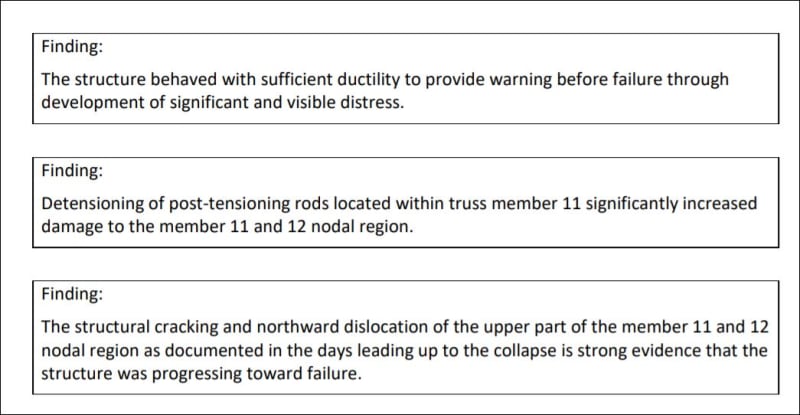

I find this part interesting - and damning to those at the March 15 meeting. From page 66 of 90.
Many items are eerily similar to points and illustrations previously presented in this forum. Kudos to all.
I see what you are seeing.
Where does that diagram originate? I think I have seen it but do not recall.
I can't believe that everything from the south end adds to a value at node 10/11. The arrows seem to show the horizontal shear from the diagonals but I am not sure.
Are they superimposing the PI forces?
Thanks,

The diagram came from the link in the post above mine - Attachment 73.
Thank you. I do not think that is correct. I do not see how node 8/9 can have so little shear transmitted to the canopy. Must be something to do with elastic changes in dimensions - they found similar numbers 4 times, though the last one was a bit more reasonable. Could this be the effect of elastic shortening from PT in the deck?
The simple truss analysis of years ago assumed things were rigid members with pinned joints. Reality can be different.

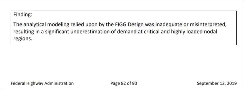

The killer "Finding" ----------
I do not comprehend the difference between FIGG calcs and the NTSB results - - anyone???
Surely FIGG will have a comment.
In a previous post I had said "There may be other problems yet undetected" - this may be one of them. If the NTSB report is correct March 15 may have been the most fortunate date available.
I haven't read it all, but did anyone find mention of bending/frame action, and also axial shortening in the top and bottom flanges due to both shrinkage and PT?
hokie66 (Structural)9 Oct 19 21:51
The solid modeling software should address fixities at joints, but I have not read any conditions of that nature.
The Feds ran 4 runs and got different answers each time - by maybe 10% - maybe more.
Strikes confidence in me.
Have done some work outside - had time to think.
End vertical reactions are pretty much equal. Member 2 is much flatter angle than 11, so there is a greater horizontal component thrusting into the canopy and pushing on the deck than at member 11.
So it appears that to balance shear loads to the canopy we take node 2/3 at 2182 kips AND ONLY 464 kips northbound at node 4/5 for a total of 2656 kips and that will balance all the remaining shears pointing southward. So the arrows are backwards on several nodes.
Am I not corect?
Same idea for the deck. And arrows are pointed the wrong way there too.
I am basing this on a free body of the canopy - horizontal forces into the canopy must balance to zero or the canopy will wind up in Sweetwater.

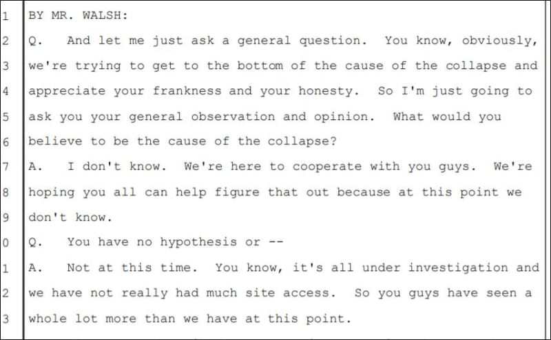

Quote of the week - or year - -
"I don't know".
Interview of EOR March 20, 2018.
