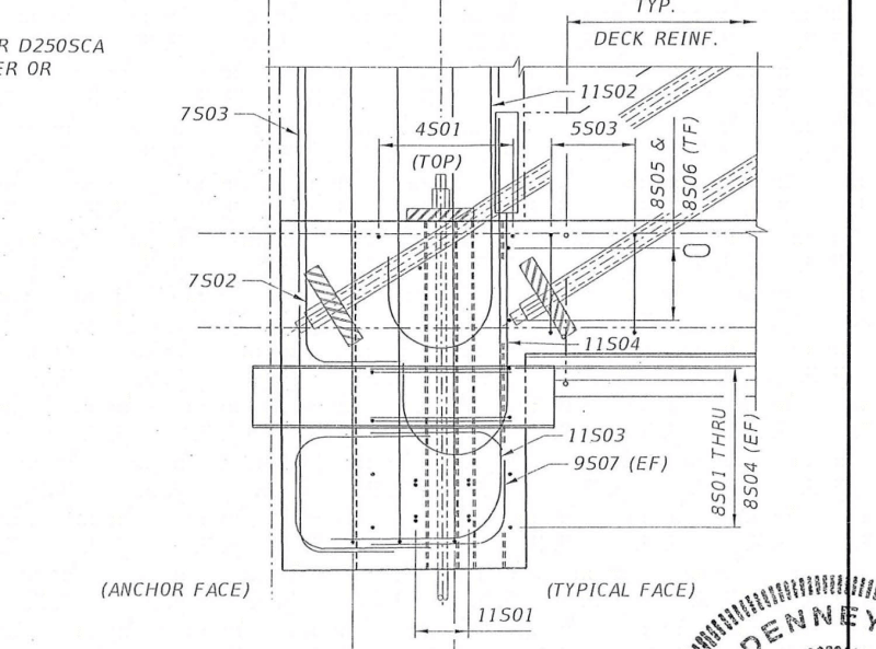

jrs_87 (Mechanical), Tomfh (Structural) & Sym P. le (Mechanical),

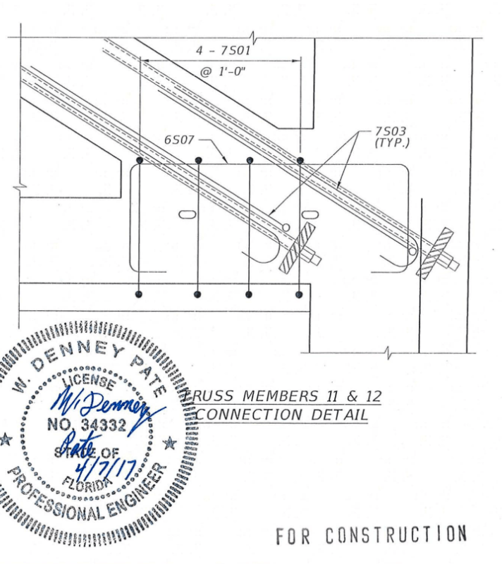

The horizontal bar above the lower PT rod makes me think it is bar mark 7501. Thus the shearing plane may be above the 4x7501 rebar since a failure occurs at the plane of the least resistance. We probably need more photos to confirm but the first 7501 is visible in Fig 67 (clearest), 65, 64, 63, 60 and 58 of the OSHA report.
Correction
Found the deck debar drawing depicted below
The horizontal bar in the photo should be from the typical deck reinforcement (5S01).
I think the cold joint under the south part of contact between 11 and 12 and the deck had failed during earlier stressing in the form or under other support conditions. The strain on this joint caused by deck stressing could be the early movement.
The joint was not intentionally roughened and the break was quite clean across the deck. Member 11 seems to have simply slid across the deck.
Vance Wiley (Structural),
OSHA report mentioned "There were a number of rebar crossing the construction joint, but not all bars could be considered for shear transfer because of lack of development length. Industry standard requires that “shear friction reinforcement shall be appropriately placed along the shear plane and shall be anchored to develop fy on both sides by embedment, hooks or welding to special devices.” This criteria excluded some of the rebar crossing the construction joint."
It is possible some bars, including the L and J bars were too short and too close the shearing planes. When the 11/12 was separated from the span concrete around the bars not having adequate development (too short above the boundary of failure) could be grounded and disintegrated resulting the failure resembles a blow out.

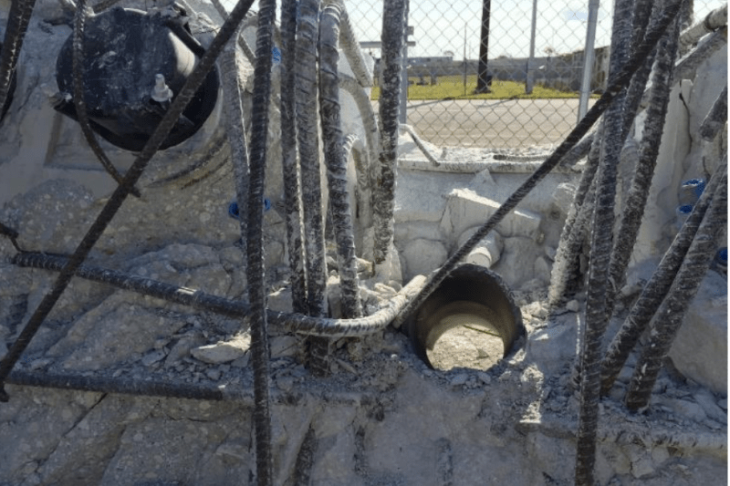

Vance Wiley said:
I find it interesting that the concrete around the J-Bars is simply gone. Hit them with a garden hose and use them again. No evidence of stress to the bars.
Where is the concrete? It looks like the concrete blew out like a hand grenade.(Maybe it was terrorists?)
If this is the way 8500 psi Titanium DiOxide concrete works there needs to be a LOT of confinement reinforcing used.
Please comment - I think this is gonna prove critical in this case. Does anyone have experience with concrete and aggregates like this? Is it common in FDOT structures?
Thanks,
I find it interesting as well. It is one of the least predictable aspects of the failure. I suspect the concrete failed without too much deformation of the bars since the upper longitudinal bars were in compression and terminated above the shear plane. The J pushes into the block of concrete and causes a concentrated splitting force near the outside face of 12. The high strength concrete tends to splinter more.
Playing devils advocate here, the simply sliding argument doesn't hold water. For that to occur, it had to go somewhere and it couldn't. It was constrained by the lower PT bar and 12. To say that it slid is to say that something ruptured, eliminating the need for sliding. The video seems to indicate that 12 held its ground initially in the collapse sequence. If the argument is that 11 slid in conjunction with 12, that would require the canopy to hinge also. This is a static impasse.
This leads me to believe that the initial failure was a blow out of 11. Perhaps the bottom end blew out and the PT bar sleeve was a guide for it to follow as it continued to crush. As I said earlier, it seems that 12 was brought down by the canopy, but that doesn't mean that a good portion of the node didn't crumbled in an initial rupture with 11.
Figure 60 (OSHA) shows that the separation is at or just below the deck. I think this eliminates the possibility of it being rebar intended for the above slab block. I haven't found the rebar drawing for the deck, at least not one that I'm any good at reading.
jrs 87 said:
Anyone care to help refine this? I have not yet reconciled deck level with PT bar and rebar position.
You should draw the green line going around the back side of the plate (the plate stayed with the deck). It looks like the shear plan dips down a bit too quickly behind the plate.

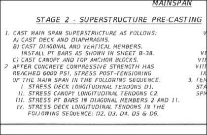

I keep wondering if it would have been prudent to stress the deck before casting the diagonals and verticals.
ADD Or is it a good thing that it failed when it did instead of after another year of work and perhaps a greater loss of life and injuries?

Apologies to FIGG for suggesting they should have stressed the structure in increments and balanced. They require just that in STAGE 2, Sh. B=109 Note 2.
