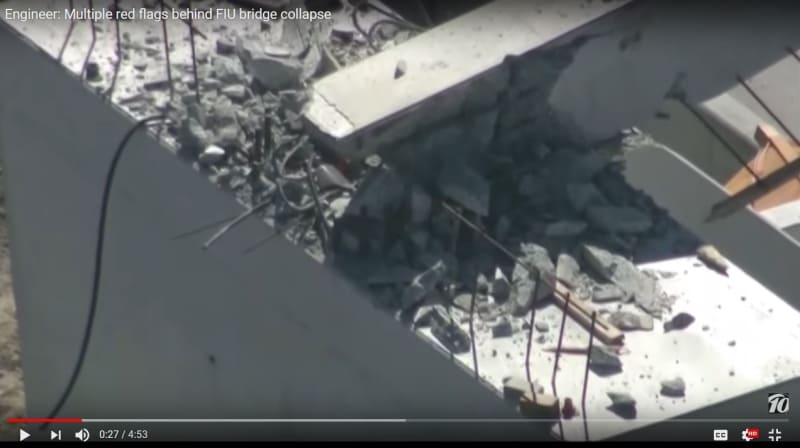

Tomkat: I can't answer your question about cold joint strength (details outside my field), but it's been discussed. I'd assumed #11/12 slid off the end of deck after breaking at cold joint, but recently someone posted a different view of #12's end that shows it broke below the cold joint (which held). The 'leaked' photo showing cracks at base of #11 after shoring was removed shows a crack traveling along the cold joint.
This is a frame from Engineer Multiple red flags behind fiu bridge collapse
It looks to me as though the rebar for the tower (or the diaphragm for the north span?) is intact behind #12 lying on the pier?

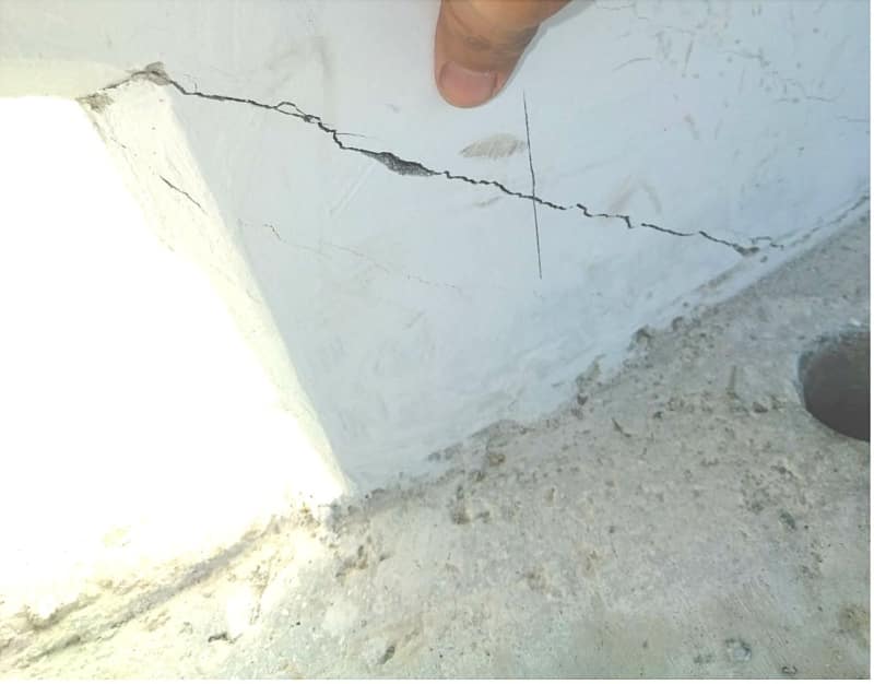

waross, in looking at the way the post-tension bars were installed, they acted like anchors in the deck, below the shear line of observed cracks. If one were to put a cable alongside the diagonal for the purpose of pulling it off the end of the deck one would anchor it just the same way. In an early post I took a shot that the compression load in that diagonal was approximately the full weight of the bridge; the total compression stress was from that was in the mid 4ksi range for concrete that was supposed to take 8.5 ksi minimum. The additional tension was 5-10% of the dead load (sofa-cushion estimate).
From this I have since concluded that the most likely failure was to continue to fail the connection that had already failed - the shear line between the diagonal and the deck. Only an inch of relative movement would exceed what the rebar bridging that connection would be able to take. Whether the rebar failed in pure shear or because of excess tension as the embedded ends were displaced, I don't know, but the overall failure looks to be entirely from a loss of shear capability.
From earlier threads and information there are two tensioning bars in member 11, one high and one low. Apparently the top bar had been further tensioned and it was during the tensioning of the lower bar when the failure occurred.
The top bar remained in place, but the bottom bar, which was anchored into the bottom base was ripped out of the member 11 during the collapse thus showing that, at some point during the collapse, member 11 became detached from its connection to the base. This ripping out essentially shortened the bar leading to the tensioner sticking out the top.
Now whether this was cause or effect is not clear, but many here believe that the extra tension on the bottom bar added to the shear load of the joint between 11,12 and the base leading to a shear failure in that joint, perhaps initially only of a couple of inches, which then lead to a sudden failure of the rest of the structure. Now how that complex joint was designed, analysed and reviewed / approved is probably the key design issue here as wiktor states. On the design data available and evidenced by the cracks seen, it looks like the weak point and is not over encumbered with re-bar.
