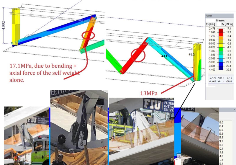

Problem is they had warning that something was wrong (per cracks) 10-14 days before they moved the span and nothing was said until after the move. Before moving, the span was supported only at ends as it would be on the piers, so they could have done 'real world' tests/adjustments. Many here say the 11/12/deck connection was weak, Toomas Kaljas ran FEA that showed high 3D stress there, but no one's estimated the strength of the connection (maybe not so easy). The 1/2/deck connection held after the collapse, as did vertical #1, LONG members 4 (no PT rods) and 2 held, but member 3 had much damage even though it was ~vertical - just correlated this with being the only other member with odd/high 3D stress.

I expect that when tension was applied to #11 as part of the move it eased back on the crack and then when the post-tensioning was relieved the joint opened again; so they thought that re-applying the tension would close the crack.
In the pictures in the FEA stress analysis, the diagonals should all end flush with the top of the deck as the deck was poured first and only re-bar and friction was holding the diagonals in place. The stress analysis does not show the finished size of #2, which nearly doubled in depth and probably accounted for its survival.
Would it have made any difference if they had made a raised pedestal as part of the deck pour below 11 and 12 so the construction joint on 11 would have been perpendicular to the axis of 11? I'm assuming no change to the rebar placement. The bottom of the pedestal would still see significant shear, but at least it would be one solid piece of concrete.
I'm just really bothered by a construction joint passing at an angle through the area with the highest loading. Is that an unjustified concern?
