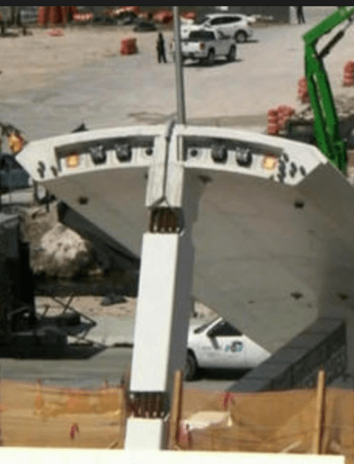

Nasty looking cracks. Not sure exactly where those two photos were taken, but those are not off form finishes, which may indicate some attempt to repair or conceal has been done previously. Regardless of whether release of these photos was an accident by FIU, the newspaper is giving us information which the engineering community needed. The NTSB should get cracking with releasing the preliminary report.

From the MH article: "Outside experts have zeroed in on that truss member, identified in plans as No. 11..." The angle of the member suggests it's #11, too. It's just inches away from the area shown at the end of video 560.

The photos in the Miami Herald are at the base of member 11. They are supposed to have been taken following the application of tension to the bars in member 11, and before the lift, which must have taken place after the white coating, which is not apparent in the cracks.
I think the photos support the theory that they thought that applying tension in the bars would pull the crack(s) closed without understanding they were levering the member off the deck instead. The part breaking off is not in the main load path of member 11 and shows what looks to me like lateral movement. There is little doubt in my mind that, if the cracks were caused by lateral slip induced by the tension bars, the additional load from the bridge installation would make that displacement greater, possibly by a lot, as the rebar between the members and the deck bent and the concrete it was embedded in gave way. Would their discussion then be about what the greatest load the bars could sustain in order to close the cracks?

A lot has been made of the joints at the ends of member 11. I agree that these joints had little hope of surviving, but I think focus on the stress bars and axial capacity of the diagonals is too narrow. To me, shortening of the top and bottom deck due to shrinkage and post-tensioning, resisted by the diagonals, made cracking at these joints inevitable.

It looks like someone made a vertical pencil mark across the larger crack so they could tell if got worse. The larger crack appears to turn horizontal to follow the joint with the deck toward #12.
Is there any way they could have added reinforcement around that area to save the bridge at that point in time?

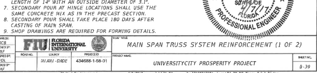

One question for those who are able to decipher the released drawings - Is there a clear picture of what the reinforcement looks like in the 11/12/deck interface?
What was actually connecting the compressive forces on no 11 to the lower deck? I've not seen in any of the drawings posted to date re-inforcement details that explain that.

From the information in the drawings, I doubt that I could draw details of exactly what was intended in that joint. The 8-#7 bars in the web member would seem to be woefully inadequate, no matter how they were developed into the deck. And I saw no indication of extra confinement reinforcement in addition to the column ties.

LitleInch: "Is there a clear picture of what the reinforcement looks like in the 11/12/deck interface?"
I think the info is on sheets B39 and B40 which show up out of sequence in the group of drawings posted by jasm (Civil/Environmental)21 Apr 18 02:37. The areas of interest are:
The bottom of #11/#12
The section showing typical rebar placement

This has better detail from above referenced doc page 86/110 B-61 comparing #1/2 to #11/12. There seemed to be more rebar in collapse photos than in #11/12 here - I looked for it elsewhere in prints but didn't see it... like what's sticking out the bottom of #12 where it's resting on top of pier.
On page 64/110 B-39, note 8 says "Secondary pour shall take place 180 days after casting of main span". Pour sequence elsewhere said 1) Deck, 2) members, 3) canopy, so I wondered if this meant 180 days between deck and members being poured (probably a dumb question, but time lapse messed up my perception).
Thanks for the better detail.
I think Note 8 goes along with Note 7, and only applies to the concrete for the hinge locations. I remember seeing pictures after the collapse that showed the hinge locations hadn't been filled yet. They had slings through the gaps.
