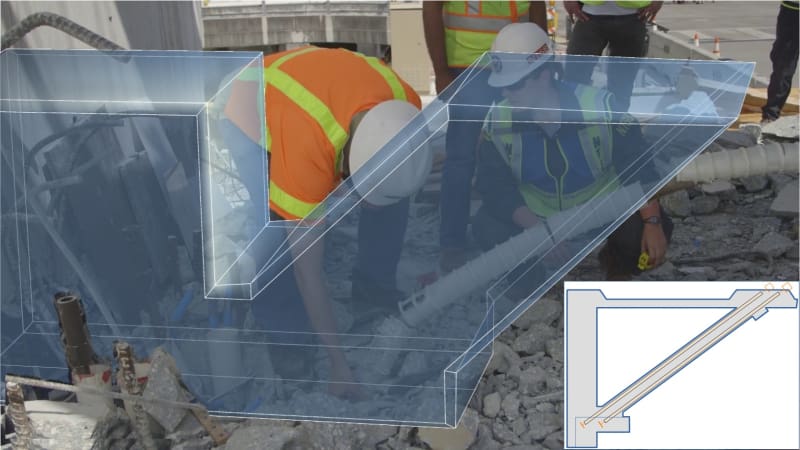

I originally created this image at an early stage in this thread, and not knowing the dimensions, I drew the wireframe outlines of #11 and #12 far too wide. Their width should not encompass the two pairs of white vertical pipes/sleeves, a detail which is rather critical. (I realize this wasn't the main point of jrs_87's post, I just don't want to perpetuate an incorrect impression about this crucial area.)
A much better version of this idea was posted by
Meerkat 007 said:
