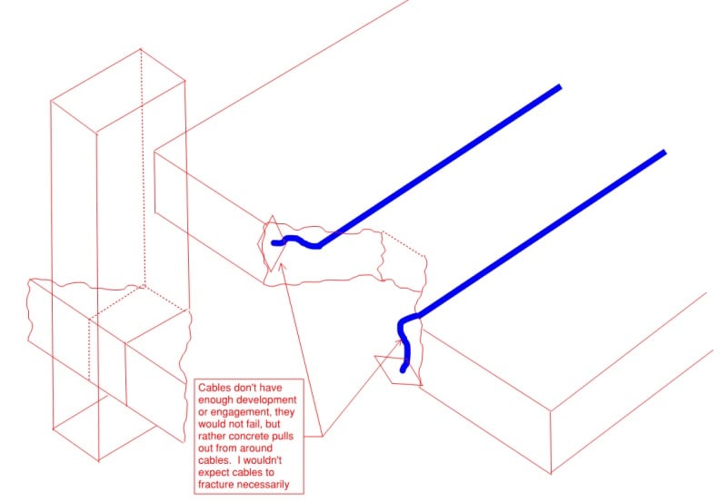

Like Ron, I believe the paucity of mild steel reinforcement is the major issue. My opinion, for what it is worth, is that all the joints were suspect, not just whichever one(s) failed first.
This was, as dik said, a large scale strut and tie example, and in this case the anchorages failed to connect with each other.

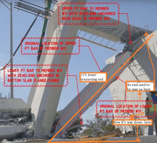

I've been having a difficult time letting go of that image of #11's lower tensioning rod protruding out the top with jack still attached. I thought surely it'd snapped as suggested by the Youtube "Smoking Gun" guy but finally realized that is likely a red herring.
Ingenuity's image above clicked.
Bottom end of that tensioning rod came down with the walkway. So it moved from diagonal to almost perpendicular as shown in orange.
That's a lot less distance . Of course it might well have got pushed out the other end.

Old Jim,
Your observation is what I thought too. This PT rod is 1.75" or 45mm diameter and does not bend easily. It was dropped from a diagonal position to the horizontal position. One end is firmed anchored at the base of the deck/end beam and can't move. The other end is totally free, being adjusted with a jack or torque wrench, so it pushed freely outward. The exposed extended distance, which gave a Youtuber the idea of a smoking gun that the rod has broken under the post tension, should be the difference between the diagonal and it horizontal projection of your triangle, adjusted for the small curve bit.
Additionally there has been a report by the authority that the workmen had completed the tension adjustment of the PT rods iat the south end, moved to the north end, finished one PT rod and was doing the second one when the bridge collapse.
If this working sequence were correct then it would be possible that all the fully adjusted PT rods have not failed in tension. The last PT rod has a jacked still attached after collapse. It is now known the bottom PT rod of No. 11, able to rip the surface concrete layer plus all the steel stirrups out and is still visible inside the broken duct. The duct has also been intermittently cut by pulling out of each the steel stirrups, as seen from meerkat007 photo.
A possible conclusion is none of the PT rods in the truss has failed in tension. This is in fact common sense as the PT rod is often controlled to stress to only a specified portion of its breaking load.

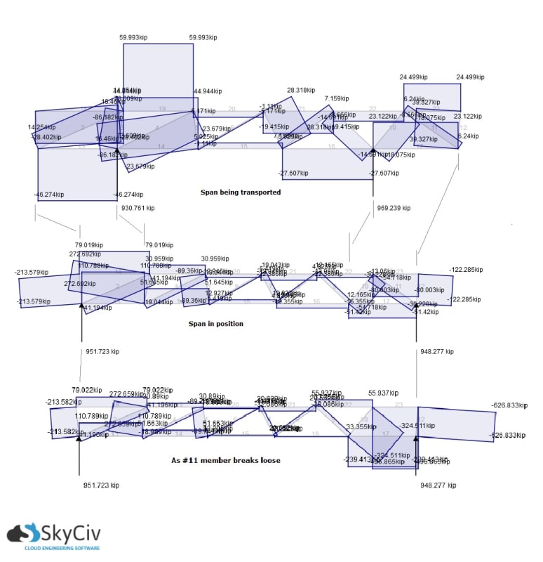

At the time of the collapse, member 11 was, apparently, being de-tensioned, following the de tensioning of member 2. The two tendons in both of those members were required as a change to the original design. In the original design the span was lifted and moved using SPMTs located at the extreme ends of the span. A design change to make the bridge 11 feet wider to allow for future highway expansion meant that the support points moved inboard. This placed members 2 and 11 under tension during the move, instead of their normal life of compression. How much these changes made overall to the design and how well they were incorporated and analysed we can only guess at and I'm sure it will form part of the NTSB investigation.
All the information used by posters is that available in the public domain, using initial drawings, videos from NTSB and individuals, other photos and record sources. No one has access to the designers calculations, analysis, construction drawings, site modifications, tests, or testimony of individuals concerned. This is the remit of the NTSB. Therefore any and all comments are educated conjecture, but in the main very informative.
Most of this conjecture over the last few days has concentrated on member 11 and its possible / probable failure in some way. Whether this is as a result of a shear failure / punch out at the base of member 11/12 (my current favourite theory) or at the top of the column with member 10 I think is very difficult to say based on current evidence. Most people favour the fact that the root action was the release of tension in the final lower tendon in member 11 which would appear to have provided, perhaps unintentionally, some level of shear capacity in the joints at one end of member 11. How these forces were supposed to be contained within the structure and whether the partial build was properly analysed is not known in any detail.
Whatever happened in the failure happened very quickly indicating a lack of ductility and redundancy in the structure. Whether any of this was assisted or affected by the cracking noticed on the structure in the day or days beforehand is not clear, nor where the cracking was noted. There were some reports that this cracking resulted in a 2 hour discussion onsite followed by the actions to de tension (we all assume) the tendons in members 2 and 11. Again why this work then took place on a brand new bridge above live traffic is clearly an error in retrospect and again should form part of the NTSB investigation.

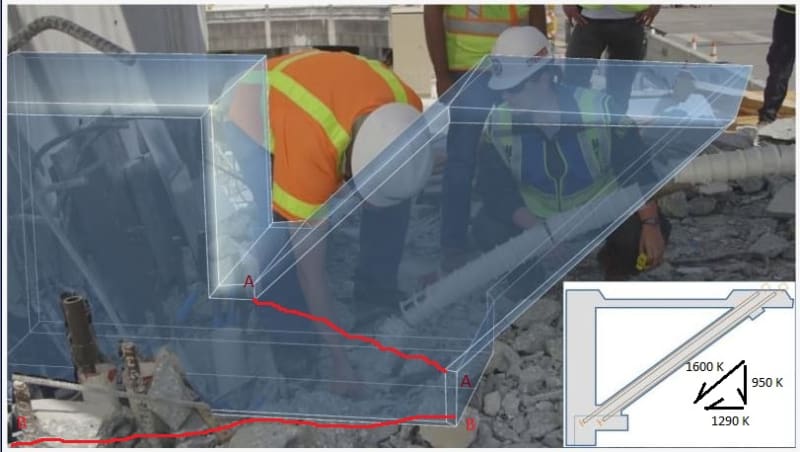

So many good comments since I last checked this thread, and too many to comment on individually. I'll just add a few more thoughts on top of everyone else's regarding this hypothetical failure mechanism (still my preferred).
Thanks to Meerkat 007 for image:
Wouldn't plane A-A, being smaller in surface area than B-B, fail in shear before plane B-B? I realize that loading and reinforcement is not equal for both, but this looks suspiciously weaker.

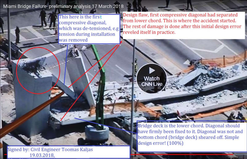

A structural engineer posted this and said the first diagonal compressive connection failed, and if PT rod broke (per "smoking gun" video) this alone wouldn't cause failure.
I estimated/calculated centerlines from prints to get nodes (end members not vertical as center of member(s) contact points were used instead of trying to figure center of force), and point loads were estimated by calculating volume of deck, canopy, members, and blisters then dividing into total weight - load was split midway between centerlines and distributed from canopy/blisters to upper nodes, and trusses/deck to lower nodes . Weight came out to 165 lbs/cu ft, which seems heavy (volume calcs didn't include 'gussets'/radius where members meet)- I didn't estimate percentage of steel or air in ducts (calcs may be within 5-10%??). I used online app (SkyCiv) to analyze forces with span being moved (supports not actual SPMT placement - I just wanted to see forces change direction on #2 and #11), with span in position, and when #11 first sheared.
Shear forces under same conditions

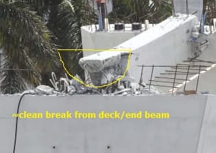

#11 was pushing against the edge of the deck - when the bridge was completed, force from the backspan would have countered this. I'd expect a break on the deck as ShearForceEng shows in 25 Mar 18 00:42 - odd how the break of #12 is clean from deck
The PVC tube under deck, cable ducts close by, and little concrete at edge creates a weak point. I'd like to see casting/rebar specs.
The engineer (Toomas Kaljas) who posted the first photo says software may not analyze connection strength, and that some engineers depend too much on software. He stresses this and discusses connection failures in his analysis of the Latvia Maxima collapse.
