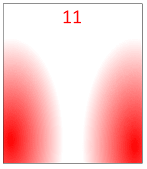

A number of posters here have noted the awkward path by which compression in number 11 would be transmitted to the tension in the deck's torsion rods/cables.
To the limited extent we can deduce anything from the MCM-FIGG proposal drawing, and the photos posted here, Member #11's lower end pushes against an area of the deck in which forces must work around service channels for the pillar #12, and also travel laterally to the location of the innermost deck tension members. The upper portion of #11's cross section pushes substantially against vertical #12, so those forces create a shear between the base of #12 and the deck, and might meet less resistance.
Summarizing these ideas, compression in the lower end of #11 might look like this figure:
Forces distributed very unevenly over the cross section of a member could result in exceeding the member's resistance to bursting in that high compression region. This is a story which could match the newcivilengineer story, linked above.
Much caution is needed though, since it's clear that #11 and its connection to the deck were redesigned after the MCM-FIGG proposal, not least to add the two PT rods (perhaps to accommodate the transporters relocated inboard), and of course the sizeable PT end plates, that must be somewhere in or under the connection.

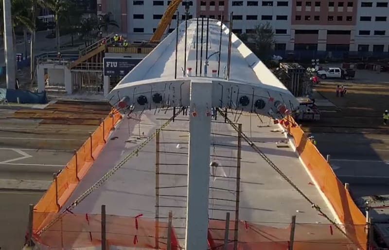

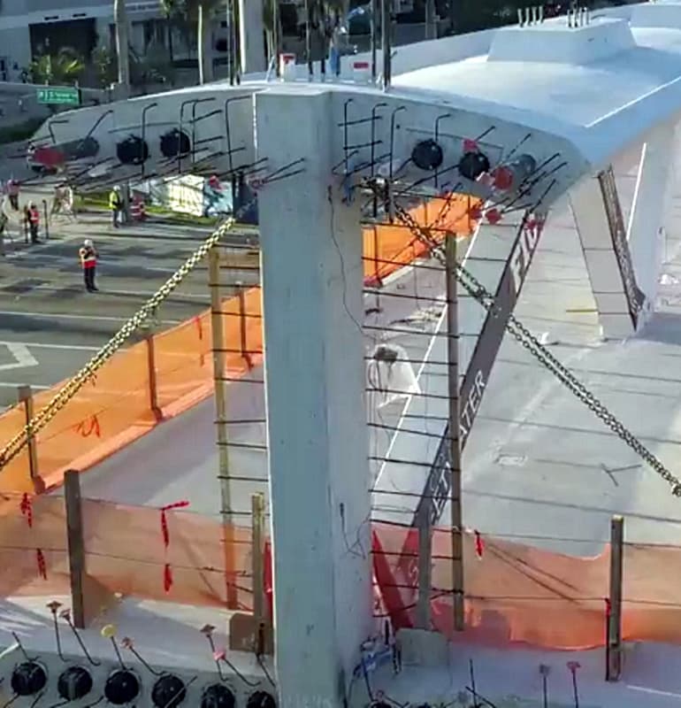

I know this is now moot, but I have been wondering about the fake cable stays.
I understand that there can be significant expansion and contraction of cable stays due to temperature changes.
I am thinking about the anchor bolts failing and the deck jumping up about two feet on the bridge up in Canada a while ago.
I would love to hear some comments from the bridge people about the possible issues of expansion and contraction of stays attached to a very rigid structure. Would the stays be stretching in cold weather, sagging in hot weather or both?

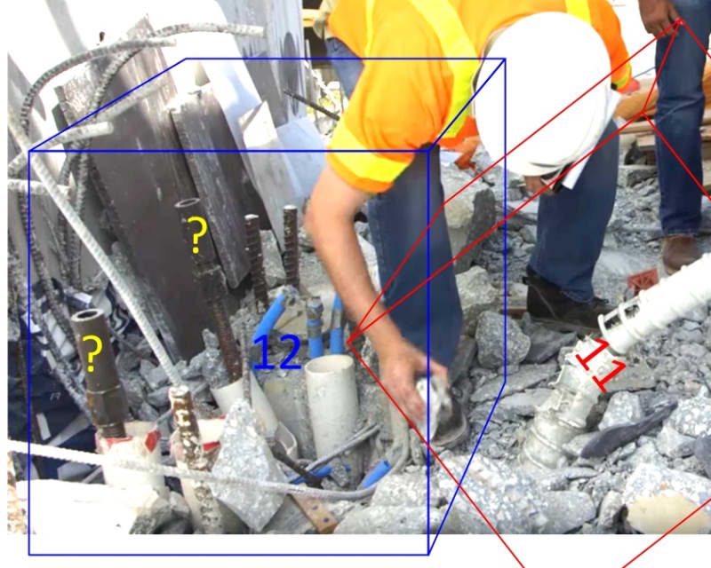

Continuing to look at the 11-12-deck area, which we know was redesigned relative to the MCM-FIGG proposal docs, looking at this screen cap from an NTSB video, what are the two items I've labeled with a question mark?
They look to be tension rods, and within the footprint of vertical member #12. But it's not clear to me if they are something that extended vertically into #12, or were actually horizontal and bent up during collapse as the end of the deck fell adjacent to the north supporting column. They seem too inboard to be the most inboard of the deck PT rods/cables, at least as shown on the MCM-FIGG drawings, and seen exposed in photos/videos of the end of the deck.
I'm wondering if they might turn out to be part of a feature to distribute forces from member 11 to the deck.
gwideman,
Is it possible that those are tensioners for the future tower that was supposed to support the fake cable stays?
And regarding the same area, does it look like there is no concrete anywhere in that area? None of the tensioners, the plastic conduit, even the rebar. It is almost like that area was purposely voided for some type of service tunnel possibly for the services or other that would have been contained within the cable stay tower. And if that is truly a voided area, then truss 11 and NO SUPPORT to the edge of the deck. It seems a totally open area.
Did they figure when both sides of the bridge were done and the tower constructed that this area would be extremely strong as both truss 11 and its mirror twin on the other side would be in compression against each other? Is it possible the bridge was FEA analyzed as a complete unit? Was the shorter section, with substantially lower forces, supposed to be built first so that truss 11 would have something to work into?

Here is the top of the canopy at the north end.
Here's the base of # 12
@gwideman, Sheet B-8 of the proposal package (linked from thread 1) shows some kind of bolt there but it looks like it's for position-keeping rather than tension.
Sounds plausible, though I don't think the drawing matches the photo. On B8 "CROSS-SECTION", and "SECTION A-A", I see a couple of vertical rods, but they appear outboard of the inboard-most deck tension rods. Then in A-A and C-C there are a couple of horizontal rods at the canopy level to tie the "Main" and (not present) "Backspan" bridge canopies together. So I don't think the rods in question correspond to that drawing.

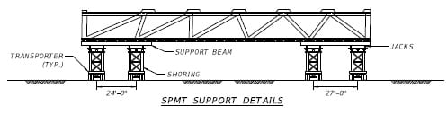

I was wondering why diagonal strut #11 has P.T bars, but it hasn’t P.T bars in the preliminary design.
I found a difference between the preliminary design and reality in transporting the main span. In preliminary design, the shoring supports both ends of that span therefore no need P.T bars in #11.
Maybe they narrowed the distance between two transporters to save money for site clearance, but they paid too much for that.

Leubong,
It has already been well established in earlier threads that there was a significant design change whereby the length of the span increased by 11 ft to allow for a future widening of the road. As such the pillar on the N side moved North into what is currently a grass area. This resulted in a change to the planned movement and location of the transporters further into the span and required the additional PT rods in both member no 2 and 11.
They were both supposed to be released once the span was sitting on the piers.
Now why it then took them 5 days to do it and after they re-opened the road is anyones guess and I would think will form part of the investigation into the collapse.
The PT bars in member 2 were apparently (according to the NTSB) released without incident before they started on member 11.
