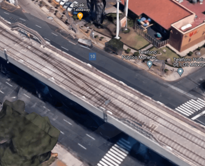

There is a cross over from one track to the other.
LittleInch,
The truss you refer to is called a cross-fame, used for lateral stability during construction and to account for lateral load transfer such as wind between the girders. Also, if the top flange was unbraced (non-composite), it would provide top flange bracing in the final condition. It does not look like that was the intent though. I noticed it earlier too, it is puny in my experience, especially for a light rail bridge. It does give the appearance that it is buckling.
