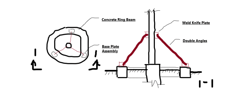

If you can back check, or estimate, the deficit in capacity, here is an idea for your consideration. Note that the angles to plate connections shall have slotted hole at one end to allow some movement of the pole, and allow the relief of tension in the angles. Once the bolts are engaged (in compression), and the angles start to deflect, the pier will then kick in to resist the remaining force.

If this pole footing is defective in resisting horizontal load, then the retrofit should have at least 3 ties
Why? Curious as to the code you are referencing.
Whoop,
The "code" was brought up by my miss-read of the OP's statement - "The existing design does not meet load requirements." I took "load" as "code".
See my sketch posted on 3 Mar 20 18:46 you'll understand why 3 ties. The suggestion was based on engineering consideration, not a direct quote of the code. But does not the code require a capable and stable load resisting system?

I decided to go with retired 13 and STrctPono's advice of using cables and turnbuckles. I plan to have a minimum of 2 braces.
For retired 13, I see that in your sketch you drew a weld knife plate as a connector. Is that connection possible with a circular pipe post?
I'm trying tosee what is the best way to connect the cable onto the pipe column...
structure567,
Yes, it is a simple shear connection, connected to the pipe by fillet weld, if the pipe is weldable.
