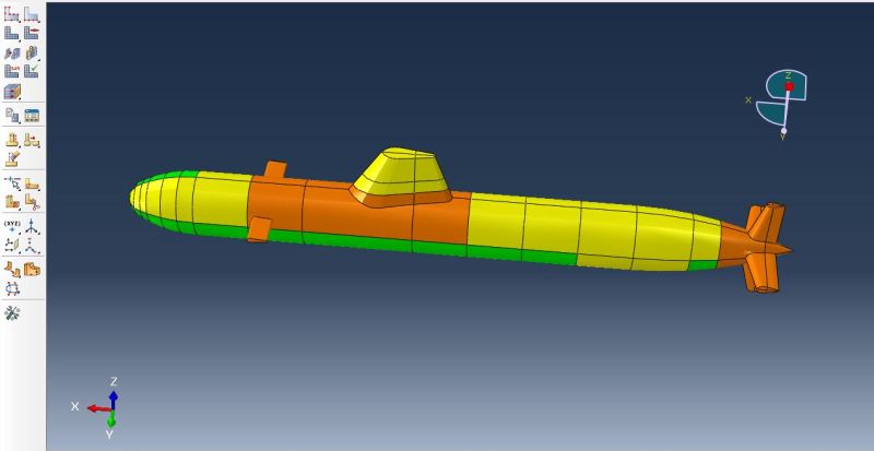

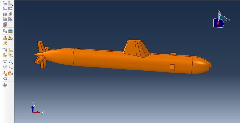

I am trying to mesh a surface model of a basic submarine I imported from CATIA for a uni assignment. I've tried partitioning the model but am having trouble. Any methods or suggestions on how to do this would be greatly appreciated.

Use existing surfaces/edges to partition the submarine using sweep and extrude for example. It should be a doddle, as we say.
Saying "am having trouble" is not enough information for people to help you. Explain exactly what your problems are and particularly what the mesher messages are.
