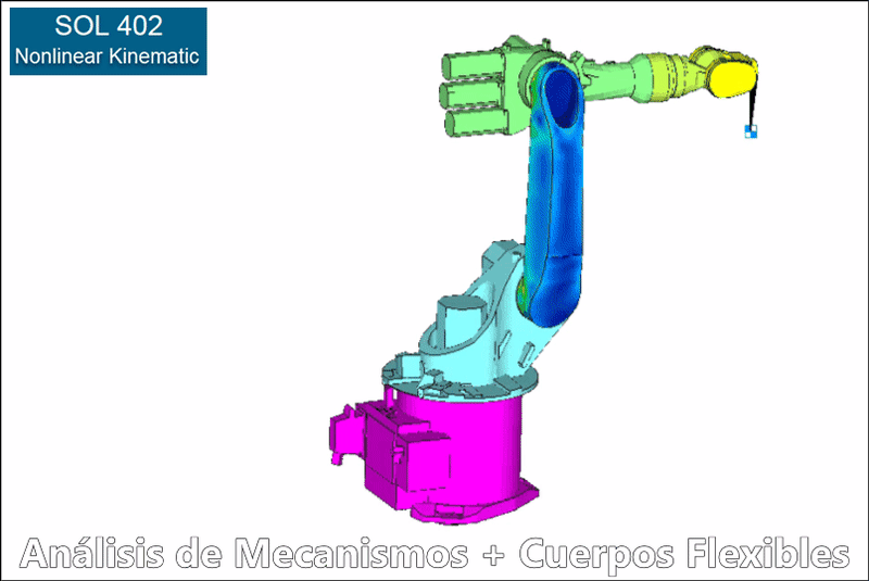

Dear Cattoni,
Please take a look to my blog here, this is what you need to solve your problem,the Simcenter Nastran multiStep Nonlinear (SOL402) module integrated with FEMAP supports large strains and large displacements, large rotations, and nonlinear materials. It supports also nonlinear kinematic joints and flexible sliders. Kinematic joints allow structural analyses of an assembly containing moving parts. With flexible sliders, you drive the displacement of parts along a line of beams that models a track. You can also add a nonlinear frictional behavior.
