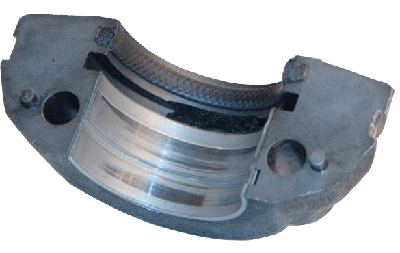

Attached is an image of a mossy rock, I mean, the worn cover and a pertinent page from a hard cover machine design handbook I bought new from the Lowell Tech (now UMass Lowell) bookstore for a mech engineering class I was taking nights. I paid the then shocking price of almost ~20 US Bucks for it. Guess the copyright date.

Is the contact surface of the bearing housing really a raised area around the perimeter, NOT a full contact flat surface?
This is what I think it should look like. Big, flat and smooth, but without the dowels which serve only to locate it, not to handle loads.
